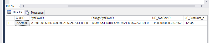

I did something similar on the Customer table.
Initial SQL result
for
SELECT CustID, Customer.SysRowID, Customer_UD.ForeignSysRowID, Customer_UD.UD_SysRevID
FROM Erp.Customer
LEFT JOIN Erp.Customer_UD
ON Erp.Customer.SysRowID = Erp.Customer_UD.ForeignSysRowID
Where Erp.Customer.CustID = 'ZZZ999'
Then I changed the UD field on that customer, and re-ran the same SQL query
The Customer.SysRowID nad Customer_UD.ForeignSysRowID never changed. Only the UD_SysRevID (and the JE_CustNum field that I changed to initiate the update).

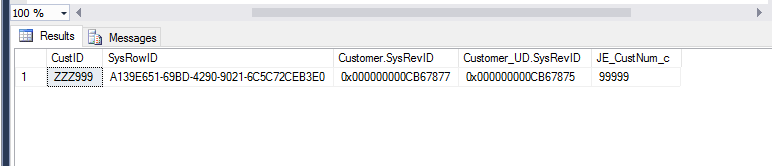

EDIT
I was looking at the wrong things.
Updating a filed in Customer_UD, did cause an update to Customer.SysRevID
Before the update to Customer_UD
After the update (changes highlighted)
