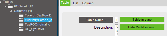

UD Column not linked to BO in Erp.BO.PODataSet.PODetailDataTable
I’m trying to use a “temp” table to import PO Details Rows in it.
The problem i got it’s i cannot use the ud column created within.
Is there a way to link those column that are supposed to be linked??
I know i can create my column manually but that’s not what i want.
My DataModel is regenerated and IIS is recycled.
