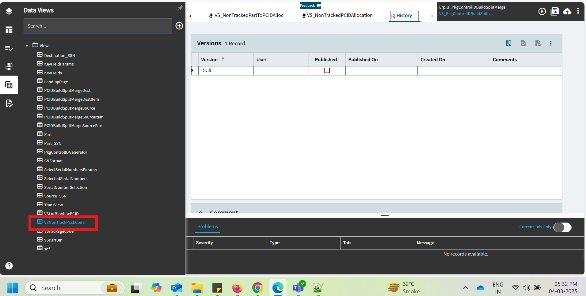

Hello EpiUsers,
I recently encountered an issue where I created a DataView linked to a BAQ. When I retrieve data using the Erp-BAQ widget, the data is successfully pulled, and I can use it in UD events within Application Studio.

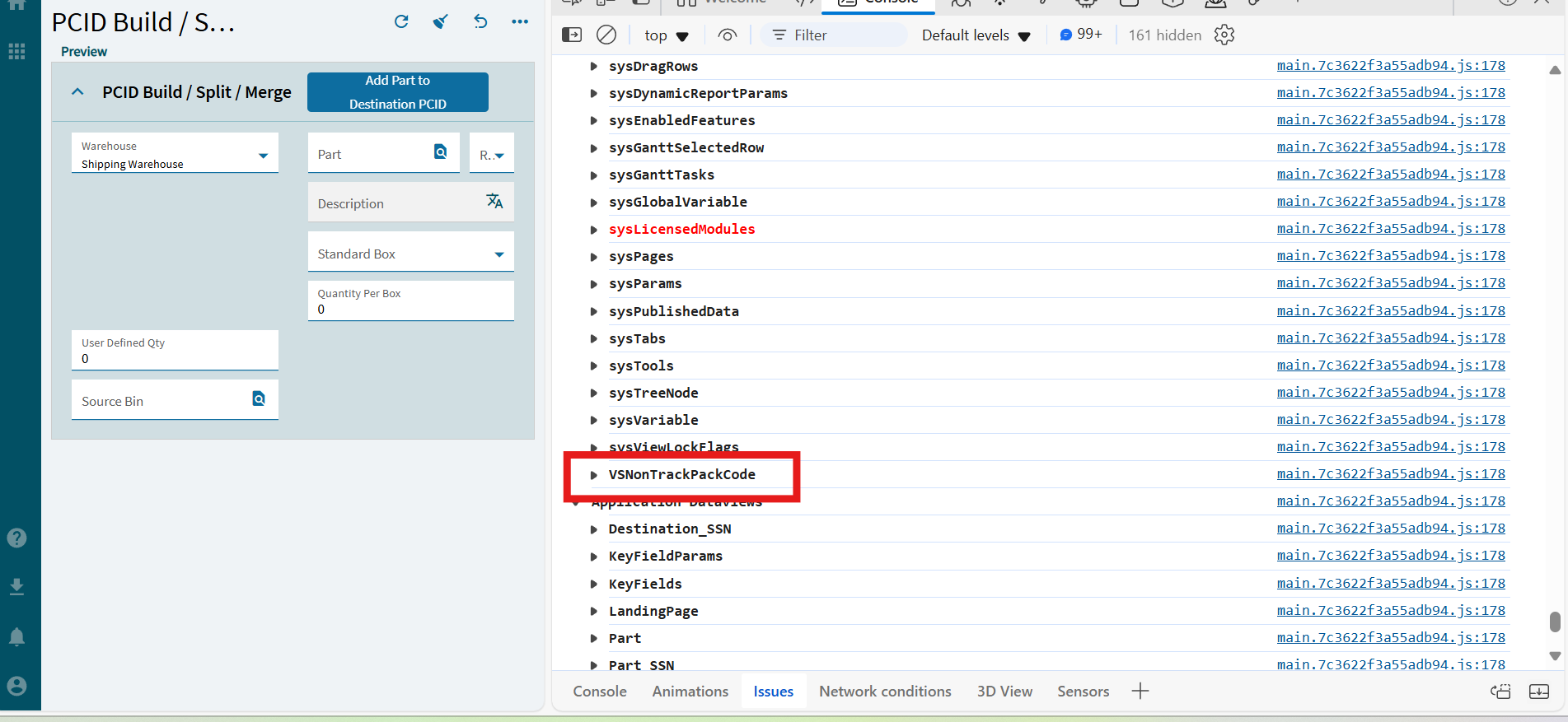

However, when I checked the debug log, I noticed that the DataView does not appear in the Application DataView dropdown. Instead, it is being moved to the System DataView dropdown. I’m unsure why this is happening.
If anyone has encountered this issue before or knows the reason behind it, I would really appreciate your insights.

Since it’s being populated fine the first time, I don’t think your dataview showing up as a system one is the issue.
Do the second transaction with DeV Tools open and after it fails, go to the network tab and look for the ExecuteBAQ call. Is it red? If so, click on it for details.
Thank you for the suggestion, @hmwillett! With the help of DevTools, I was able to locate the issue, and my problem is now resolved. I really appreciate your help!
