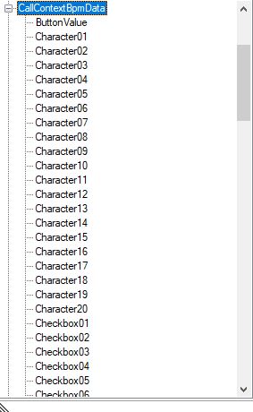

However, when I look at the CallContextBpmData, it looks like there are a bunch of UD Fields.
CallContextBpmData
Are the CallContextBpmData fields the UD Fields that I should be EpiBinding to my epiTextBoxes?

You won’t want to use the CallContextBpmData for this. It isn’t what you may think it is.
The Customer table on the MT SaaS should have a number of fields already created. The fields would still be things like Character01, Date15, ShortChar04, etc. They don’t create custom named fields on the cloud…

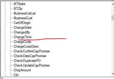

I have searched the Customer table (under the drop down for EpiBinding) and the UD Fields you reference do not appear. I have attached a snip of where the Character UD fields should show up under the Customer table.
NoCharacter
Should I look somewhere else?
There are no UD fields in Customer table unless you specifically add some. Did you add Custom Fields in the Customer Table?
IF you haven’t you need to create these in the UD Column Maintenance form. I would highly recommend you do not called them Character01 and Character02… but rather the real names based on what you’ll be storing in them.

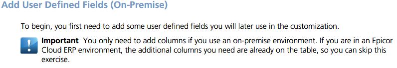

The Advanced Embedded Customization Manual (for 10.2.500) states:
This is what lead me down the path (because we are a public cloud client).
I will follow your advice and I have gone through the steps to add these columns in the UD Column Maintenance. Now I still need to put in a ticket to “Regenerate the data model and recycle our application pools”. After that happens, if I need to change any of the individual settings on these new UD columns, will I have have to put in another ticket to Regenerate and Recycle again?

That’s was more true in the Multi-Tenant days but for Public Cloud (formerly Dedicated Tenant) this is the new normal. The hope one day is that several of these kinds of items will make it to a portal that the user can initiate when desired. Start with restarting task agents, then copying live to pilot, then a Data Model Regen, and eventually - for Flex users - the option to begin an upgrade.

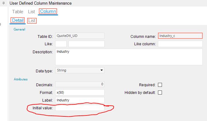

If I decide to change the initial value of a UD Column, do I need to Regenerate and Recycle again?
UDColumnInitValue
Yes
