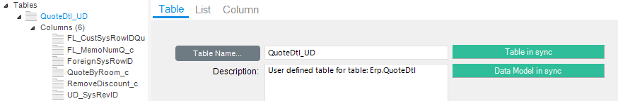

i have created the field “RemoveDiscount” the tables are in sync but its not giving an option to select it when creating a method directive.

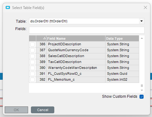

Tried all of this but still nothing, any other suggestions?
Your UD field is on the quotedtl table, and you are looking at the orderdtl bo.
So it is, i’ve been staring to long
