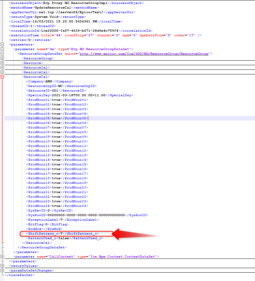

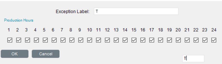

I’ve created UD field (ShiftPattern_c) on the table ResourceCal, created a EpiCombo control on the App.ResourceGroupEntry.CalendarForm that binds to the ResourceCal.ShiftPattern_c field. Looking at the trace, I see the custom field value IS passed to the Erp.ResourceGroup.UpdateResourceCal method, but it is never updated in the database.

That’s what I thought. This is the last method call in the trace and I see the new value there:
I even tried creating a post process on the UpdateResourceCal method to show the data in the tt table and the updated value is there also.

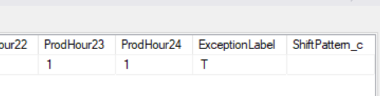

So if you do a BAQ on this, the update data isn’t in the database?
I do a database query directly:
select * from erp.ResourceCal_ud
Or using the view created:
select * from ResourceCal
The same thing… the ShiftPattern_c column is blank no matter what is set in the method dataset.
I recreated the scenario that you laid out and I get the exact same thing. I attach the label in the CalendarForm, everything else is recorded except the UD entry.
