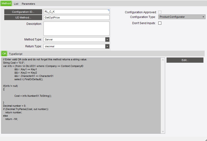

Here is an example of our UD method…
Here is our on field change…
Inputs.numAXLEPrc.Value = await UDMethods.GetOptPrice(Inputs.txtClsModel.Value,“AXLE”,Inputs.AXLE.Description);
What needs to change in kinetic to make this work? All worked fine in Classic. Currently its not populating prices for options in the UI.
No errors are coming up.

This is going to seem silly, but try changing converting the return to a Double:
Inputs.numAXLEPrc.Value = await Convert.ToDouble(UDMethods.GetOptPrice(Inputs.txtClsModel.Value,“AXLE”,Inputs.AXLE.Description));

I get this error message…
double’ does not contain a definition for ‘GetAwaiter’ and no accessible extension method ‘GetAwaiter’ accepting a first argument of type ‘double’ could be found (are you missing a using directive or an assembly reference?)
