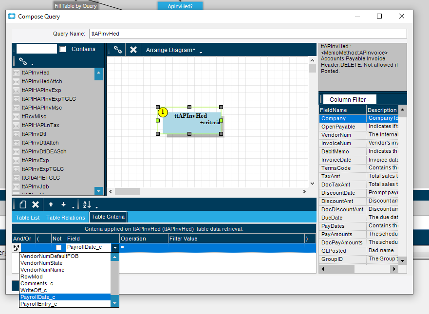

If I want to query it in method, it does:
It just doesn’t exist if I want to pull the data from it. Am I missing something obvious?
