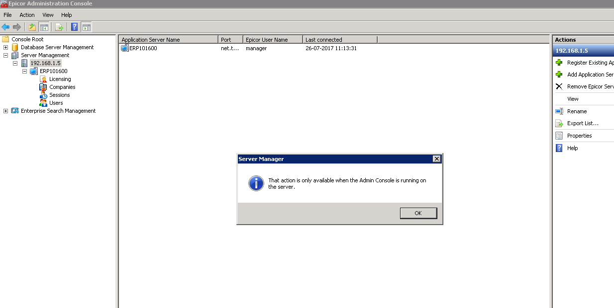

Hello experts,
While adding new application server, i am getting this error, "that action is only available when admin console running on server ". i am running admin console on the server machine,still i am getting this error .
Any suggession ?
Thanks in advance…
Remove the server you have registered as an IP address and try using the actual server name.
