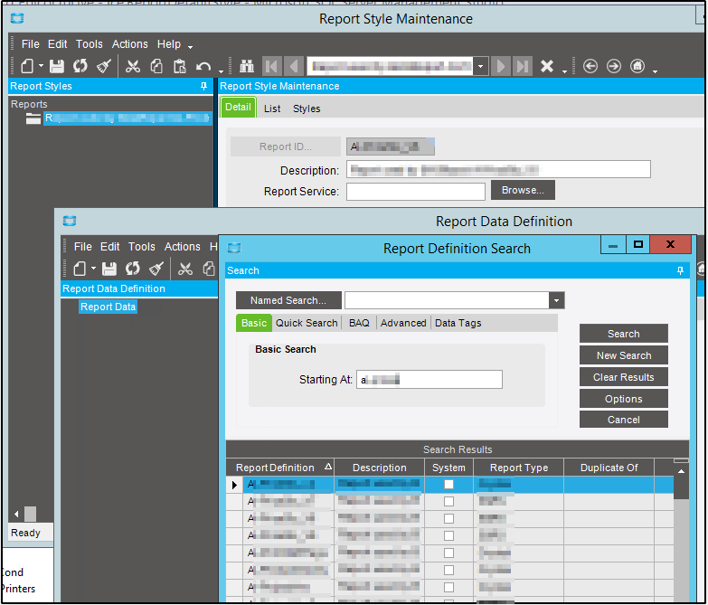

Screenshot below. Report Style is selected. Report Data Definition used to have same name, and is now deleted. Looking into the SQL tables, I see the ice.Report table still has the ReportID for this one, as does the ice.ReportDefaultStyle still has this associated ReportID inside too.

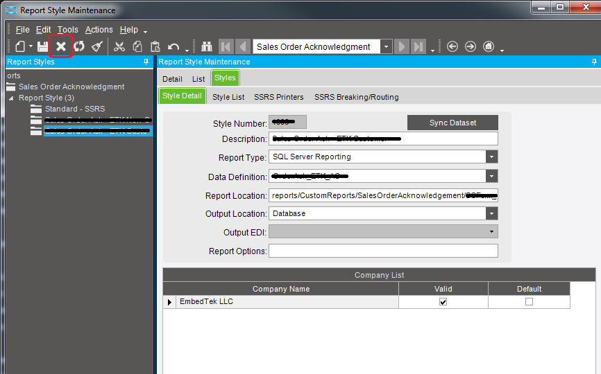

Selecting a Report Style ( here, the third one ) and clicking on the ‘X’ in the ToolBar ( circled in Red ) will delete that Report Style.
