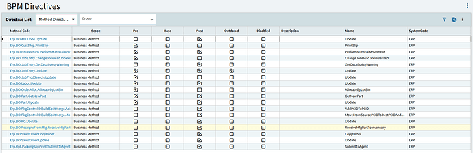

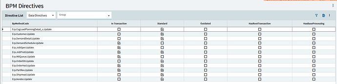

When going into the BPM designer menu, the options are appearing as black text, not blue clickable hyperlinks (see below)
I feel as though this might not be an issue relating to the recent 2026.100.5 update, as my colleagues aren’t facing the same issue.
I’m then unable to click, edit or enable the data directives after this point.

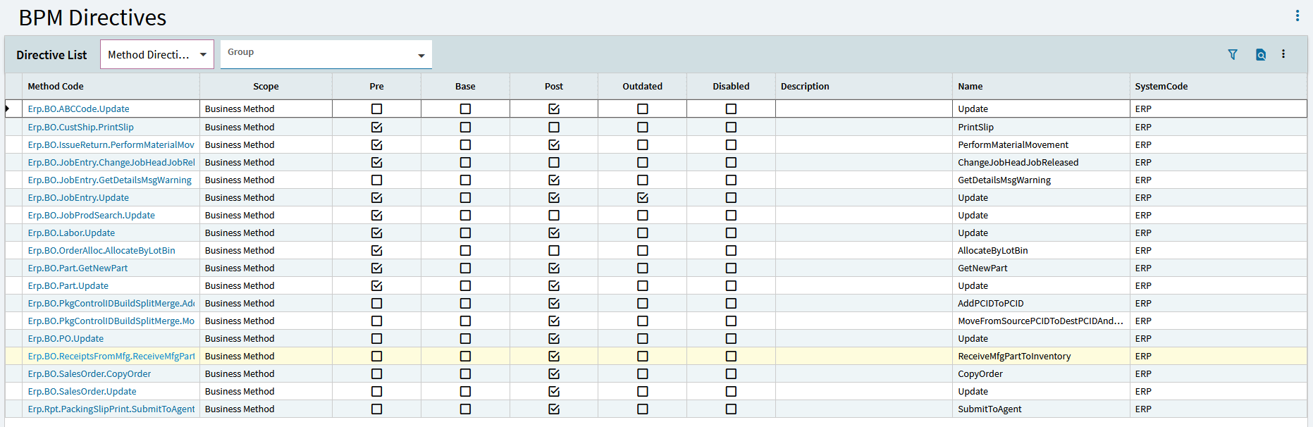

Curiously enough, this only applies to data directives. Method Directives are as normal

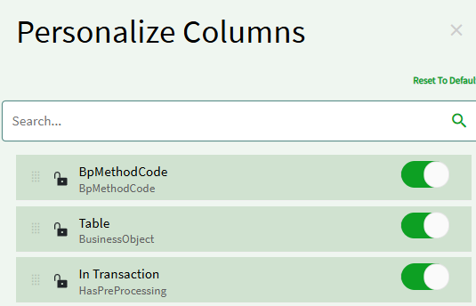

Personalize your columns and add the Table column back in. That’s the clickable link.
Edit: You can also reset it to default, that might also work.
You may also want to check your user setup and make sure you have access to the correct group and settings
This was it, thank you Genoah
