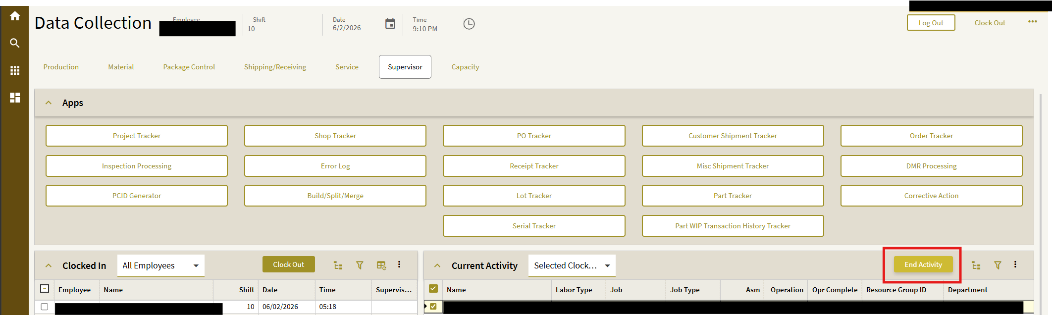

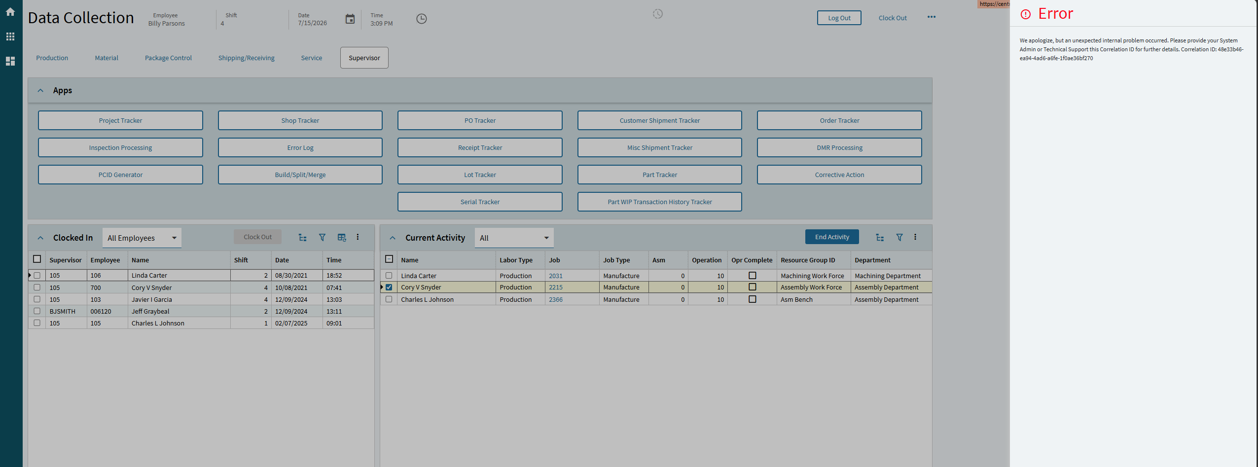

If you open MES and Clock In as an Employee marked as a Shop Supervisor, you can Clock Out other Employees from the Supervisor tab.

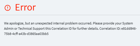

Our Production Manager attempted to End Activity for someone that forgot to clock out today, but received an error with a correlation ID when clicking the End Activity button:
Downloading the Server Log and looking for the Correlation ID shows the following:
<![CDATA[System.Exception: Unable to end activity, active labor exists

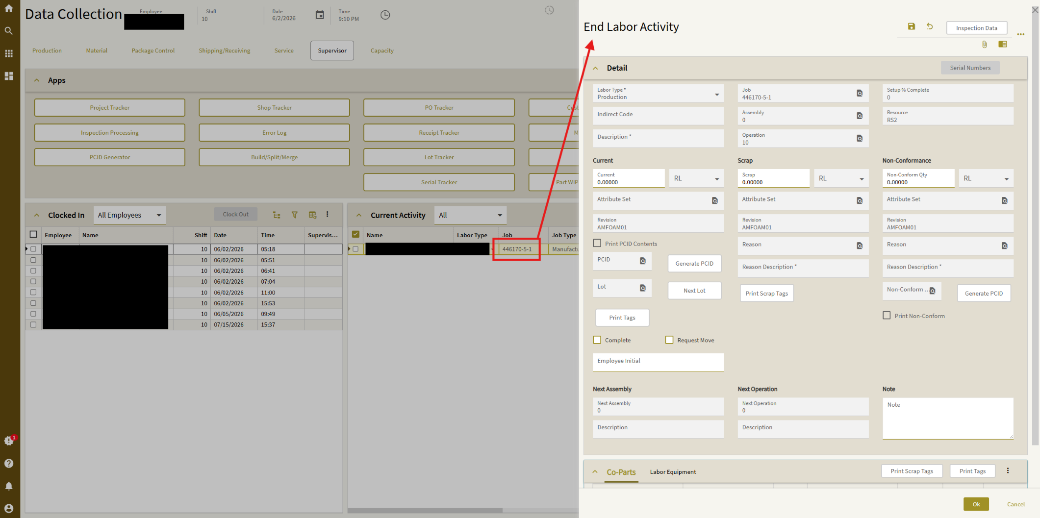

I am also getting this error as a Security Manager. I can click the JobNum hyperlink and the End Activity slide out will pop out, and I can End Activity from there.
Any chance someone else is experiencing this on 2026.100.7? Error when selecting the End Activity button from the Supervisor MES tab?

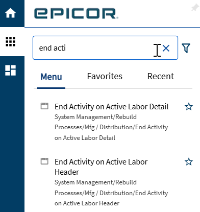

Have you tried the “End Activity on Active Labor Detail” fix?
Thanks for the response, Randy. I am not sure what you are referencing.

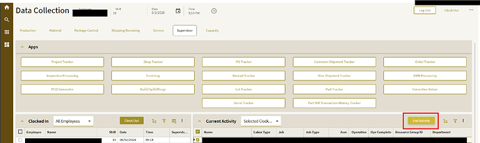

Just happened out on the floor, I went back to the office and logged into Pilot as an Employee, Started Production Activity on a random Job, then opened my MES in another window and attempted to End Activity on the Job that I just clocked into as a Security Manager.
End Activity works for the User on the main MES page, it works as a Supervisor using the hyperlink, just the End Activity button seems to error out. Figured it might be a bug or something since I can End Activity in multiple other ways.

Fix applications on the menu. When MES can’t do it these often can. But for sure log the issue you’re seeing could be a bug.

If you click on the JobNum hyperlink, does the End Activity screen slide out for you? It does for us, that is our workaround for now.
Also Clock Out on the left side works to Clock out and End Activity. Just seems to be the End Activity button that has issues.

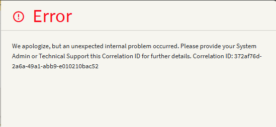

We’re getting a couple of users that try to end activity through MES and receive an error as well.
Looking at the log files, this is what I’m seeing.
**Index was out of range. Must be non-negative and less than the size of the collection.
I wonder if its related?
Per support
A hot fix has been approved for 2026.100.9
It should be delivered on August 7th
