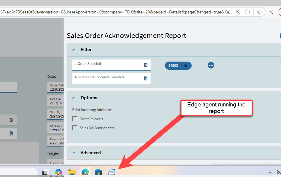

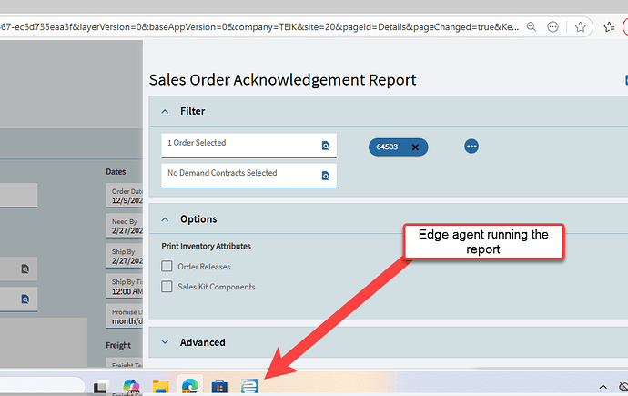

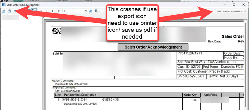

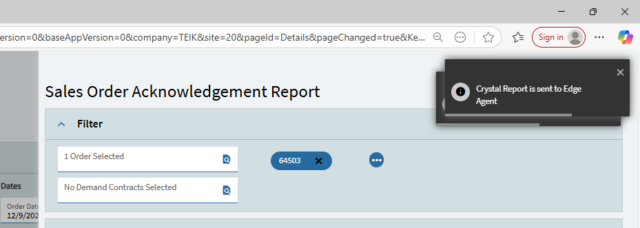

We have it working in 2025.1, browser only. The version of the crystal runtime and the edge agent setup is important. The whole darn setup is quite fussy. I think we also had difficulty early on with new server settings / privileges on the reports folder for the xml being too tight. I agree it does not download a pdf. It opens it in the edge agent.
This is what it looks like.
Nancy
The difference I see is you are using a kinetic form versus mine launching in a classic form. I should mention my report is a BAQ report and is a standalone menu item, not an added report style to an existing one. I wouldn’t think that would make a difference, but it could.
Edge Agent doesn’t work with Classic UI even if it’s launch via browser.
Edge Agent calls the Classic UI Form though when you click on a menu item that requires it in a browser. If the agent isn’t installed, it will not launch the Classic Form.
Yes that is the extent of what Edge Agent will do with Classic. It won’t process prints from Classic UI.

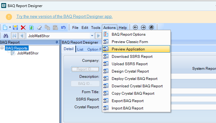

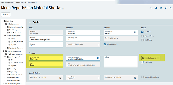

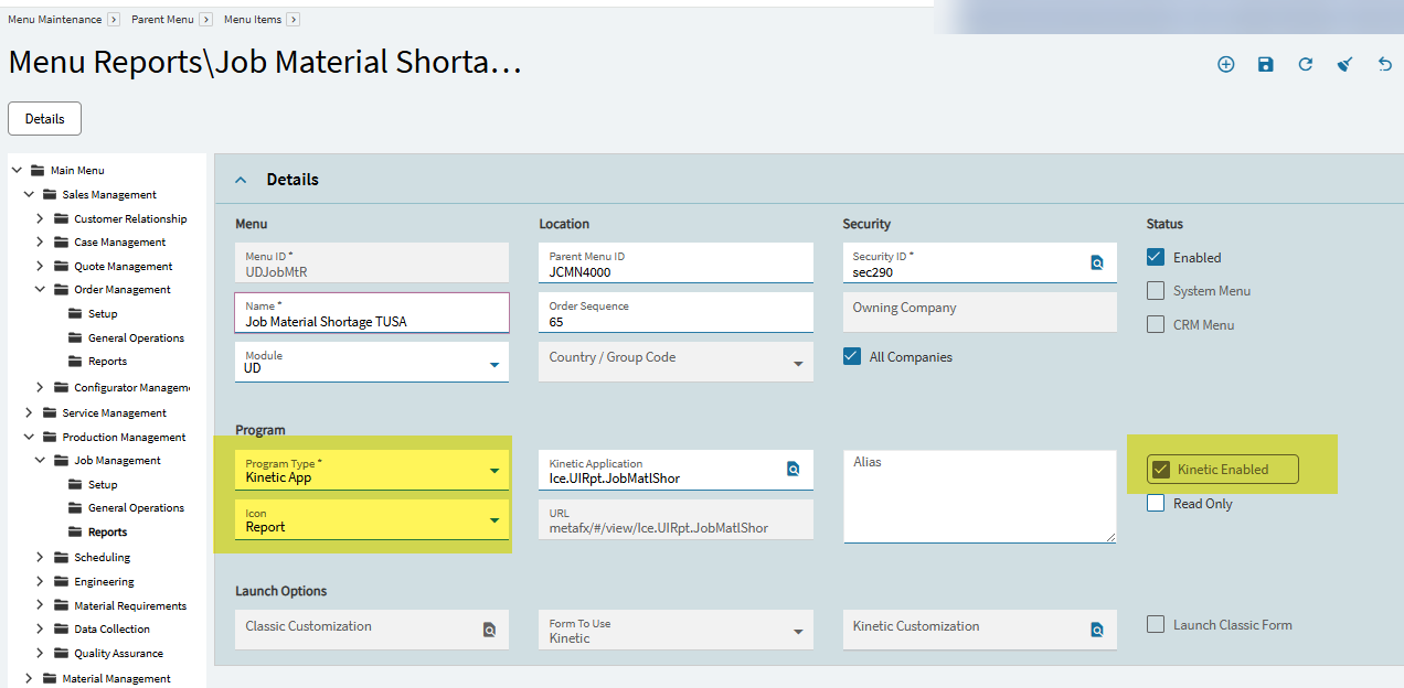

You need to make the Kinetic dialog for the baq report using BAQ report designer (smart client) via preview application. Then you can assign it to the menu for run and it’ll run for users in kinetic with browser only if they have the edge agent correctly setup and the right version of crystal runtime.
Nancy
This is likely why I couldn’t get it to work. I wasn’t deploying the reports as a Kinetic App.
This was it. Thank you, Nancy! So many seemed to have the same problem, hopefully they find this thread to help them.
