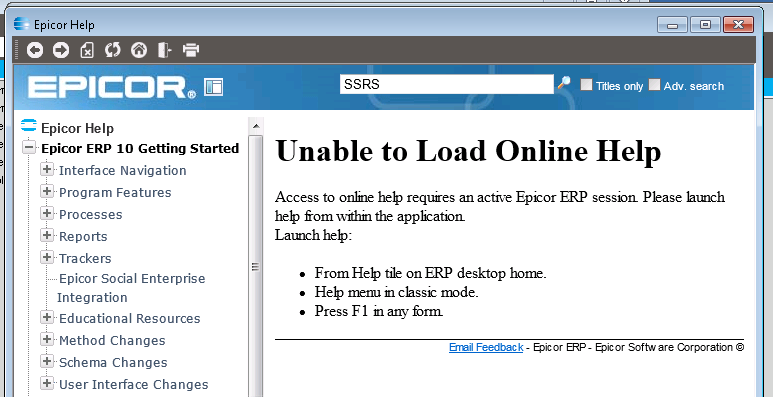

I'm getting the following error when I try to access an online help topic.
Funny thing is, is that the Help launches okay when you hit F1

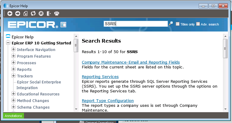

And even seems to run the search
But as soon as I click a link in the serach results (or choose a link from the tree on the left) I get the error I mentioned.
This have to do with security settings of some sub-folder in the inetpub ?

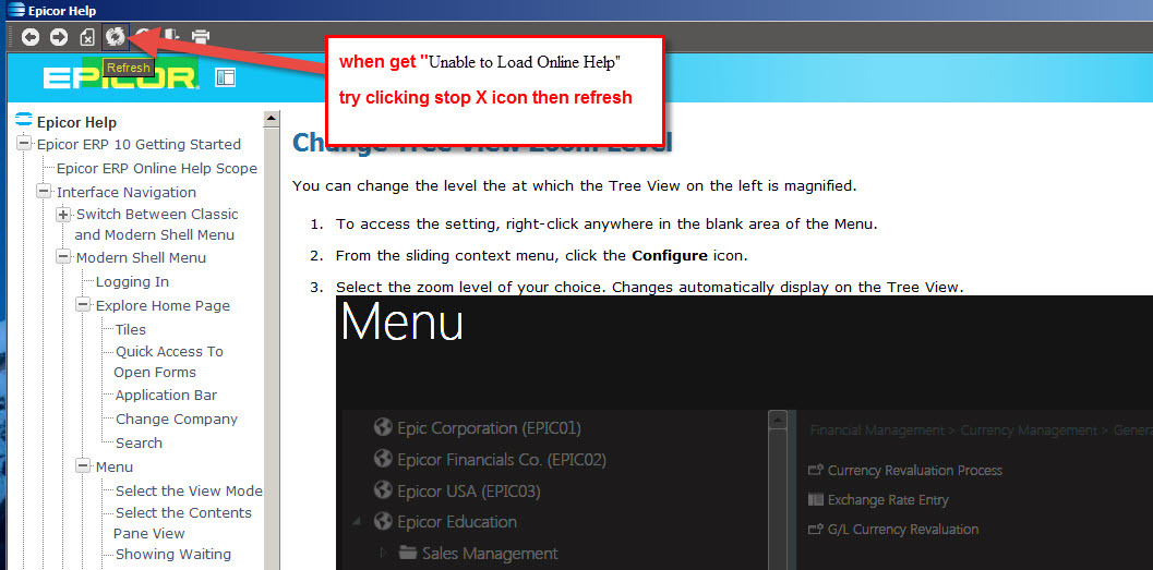

I've been struggling with trying to figure out if something was wrong with my client install, making my Help stop working, giving me and "unable to load online help" message, whereas other computer's weren't having problems.
I am posting this as a service to others who may be having same problem. Do not ignore the icons at the top left, like i've been doing! Use the stop and the refresh, per screenshot below, and Help loads again with information coming up on demand. Wow ~ silly huh?
Nancy
