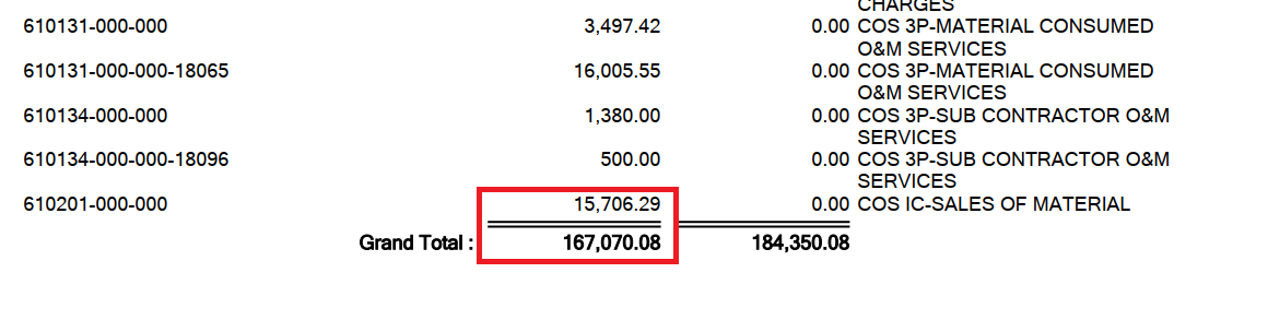

My account team unable to capture COS/WIP because the transaction is not balanced.
The Debit side is missing about 17,280.00 in the Inventory WIP Account Reconciliation Report, and we found that it was caused by these two items.
In a more in-depth investigation, these two items are bought for “Other”.
Has anyone encountered this before? What should I do to make the debit balance?

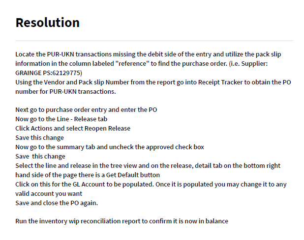

This is the resolution provided by Epicor support, and it helped solve my problem.
