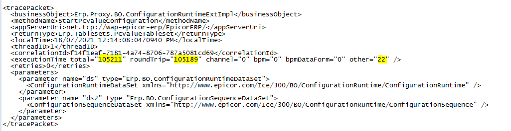

Hi everyone, a lovely sunny afternoon and I am here trying to figure out why our configurators are taking so long to load, the more lines on a quote or order the longer they take. Over a hundred lines and we are talking minutes. I have attached an excerpt from the trace log which has very high numbers compared to anywhere else. Does anyone know what is happening here and why the numbers would be so high?
This was run using a quote with 30 lines already on it. I started the trace, pressed the Configure button, waited approx 40 seconds for the configurator to load then stopped the trace.
If anyone can help it would be much appreciated. This performance is killing us at the moment.

Hi Calvin,
All the lines are using a configurator. Everything we sell is configured using one of around twenty configurators.
Closing and reopening the page makes no difference.
Re-configuring brings the configurator screen up at what I think is normal speed (interestingly enough)
Re-configuring shows no difference in load time between the first and last line.
The configurators contain between 1 and 4 BAQ driven fields, between 4 and 12 UD methods and a maximum of 20 lookups. Once loaded, they run perfectly well. It’s just the load time. I don’t actually know what is happening in that time.
