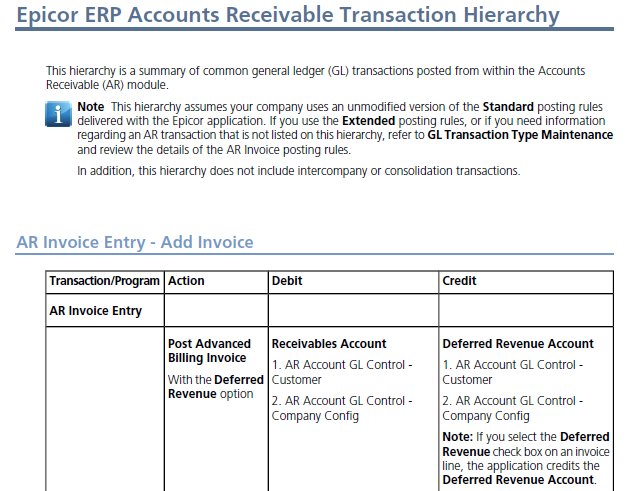

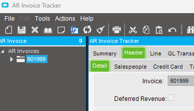

Hi Jamie, I believe if you do an Advanced Billing Invoice and mark it as Deferred Revenue the system should credit your Deferred Revenue account.

This doesn’t debit cash and it requires a Sales Order number. There is no sales order, it’s just a lump sum payment for us to draw from as orders come in. Maybe I am missing something?
