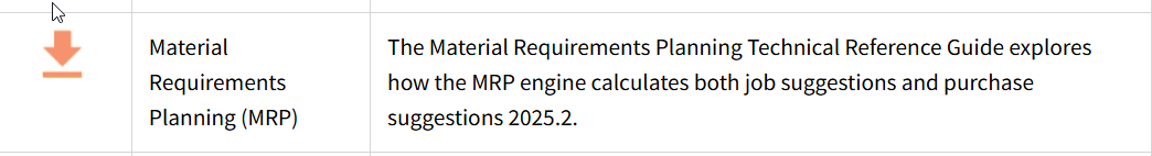

This is a great resource. You can get to it by typing Kinetic Guides Download in the help and then going to technical reference:

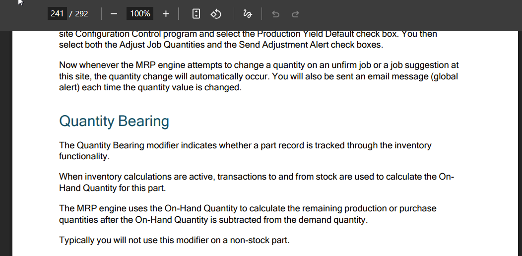

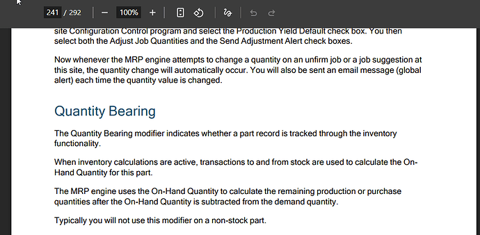

And this (below) is a lie - I mean we do this anyway, and it makes sense (kind of), but the system is designed to need qty-bearing to be true for MRP to be happy.
