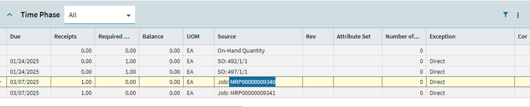

May I know why the unfirm job number changed into different number? MRP00000007597 has changed to MRP00000009340. Is because of Recycle MRP job was not used while processing MRP?

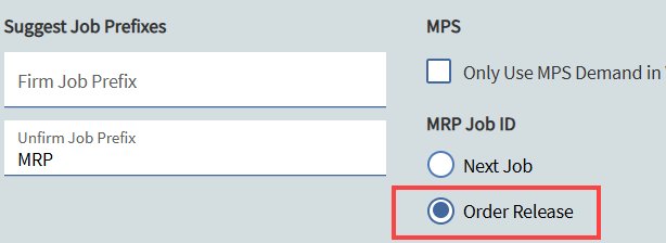

Consider that the Job number for make direct to order the MRP job can be set to be the Order-Line-Release

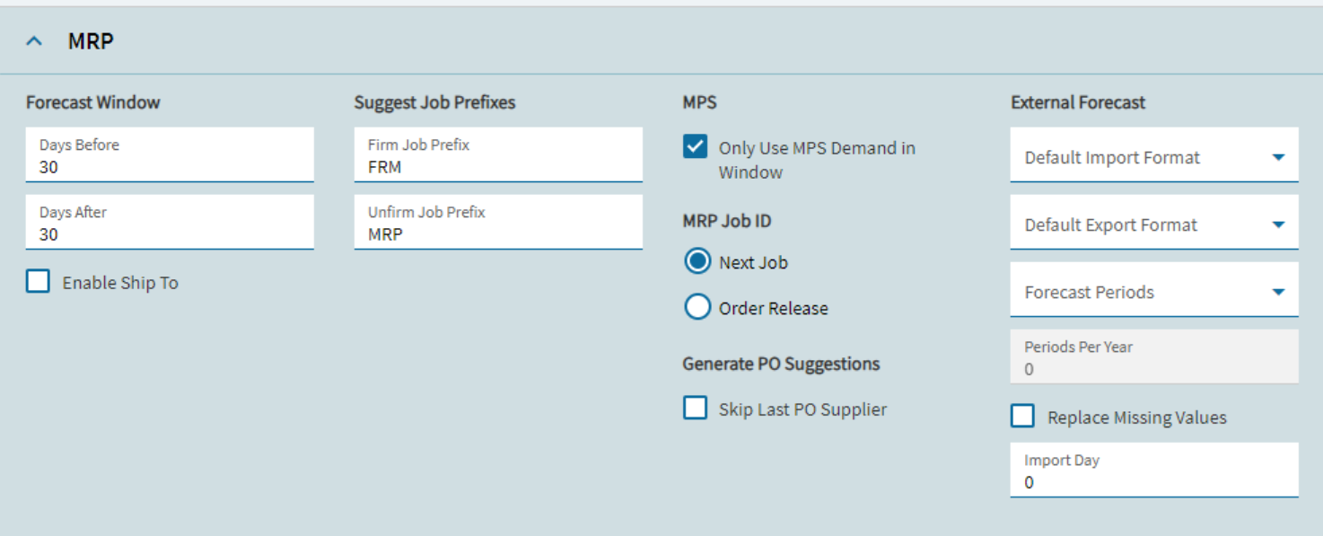

This is our setup - Is this a reason for change the unfirm job number?

  • First - do this in your pilot environment
  • Change the setting in company config, and you have make direct order release (with a ship by date)
  • Run MRP process
  • Using your favor job mgmt tool search for unfirm job or look at the job related to the order release.
