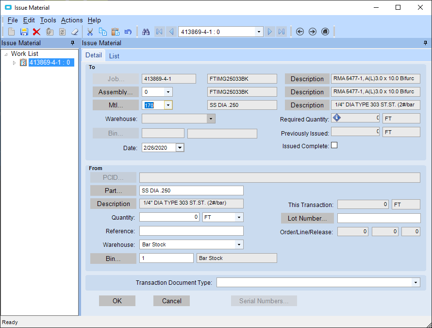

The job that this just happened on is inventoried in ft and the job has that material issued in feet so it’s requirement on the job is 0.25FT. When he initially tries to issue the material its only showing a whole number for FT and he can’t enter 0.25, it wont accept a decimal point. When he closes and reopens Epicor and goes back to Issue Material, its now showing the required amount as 0.2500FT and he can issue 0.25FT to the job. This is an interface issue only, nothing on the job is ever changed or edited to allow him to issue material, simply closing and relaunching Epicor corrects the view and allows him to issue a decimal qty.

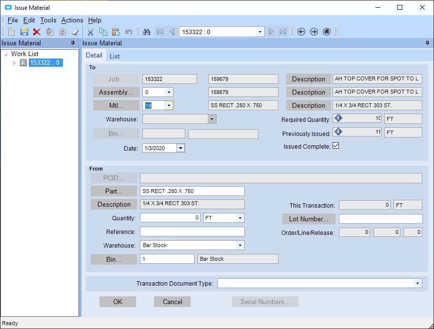

Here is a screen shot of it demonstrating the issue on a previous instance, different requirements of material but same symptoms.
And here is the same job after closing and re-opening Epicor

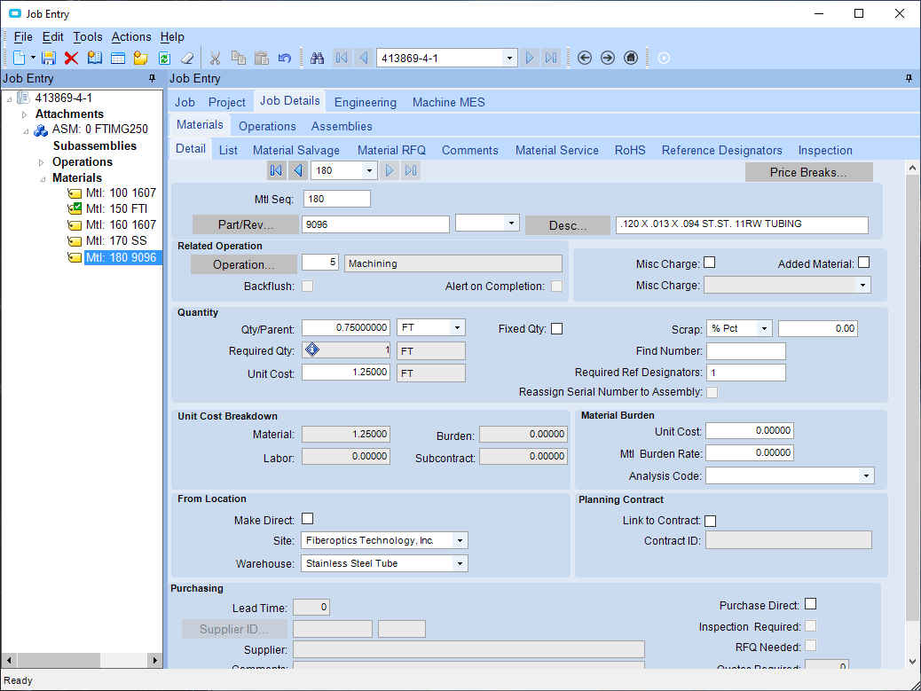

So I’m assuming no one else has seen this? It happened again today to the same user. Job entry showed a no decimal UOM on only the required qty field, but no others, and he couldn’t issue the material either since the QTY field there was a whole number as well. Both the 170 and 180 material lines were affected. The issue QTY only shows a whole number so he can’t enter the .25, or .75 that is required for the two lines. He had to close Epicor and re-open it and then Material issue worked again.

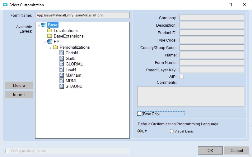

In those screen shots that don’t show decimals, the Info symbol is shown. Meaning there is a customization on the form. I’d guess it’s a Row Rule, to inform when the value doesn’t match the expected qty.
Perhaps it’s the rule that is messing things up. Especially since the rule affects the appearance of the control. Next time it appears, launch the form without any customizations, just to see if it is still happeneing.
If it doesn’t happen without any customization, Try changing the rule to “highlight” (which would change the back color, instead of adding the icon), to see if that still causes it. Might want to make a customization with the different row indicator now, and then that way you could try it out the instant this returns.
There is not a single customization or personalization on that form for the user experiencing this issue, the Info symbol is shown because it’s showing you an “exact value” since the decimal places can’t be shown, and the value is rounded to the nearest whole value.
The user is not in the Personalization list.

It was brought to my attention in material issue before, and I decided to check another screen that would report those same qty’s which happens to be the Job Entry screen. That is why I’m now showing that it happens on more than one entry screen.

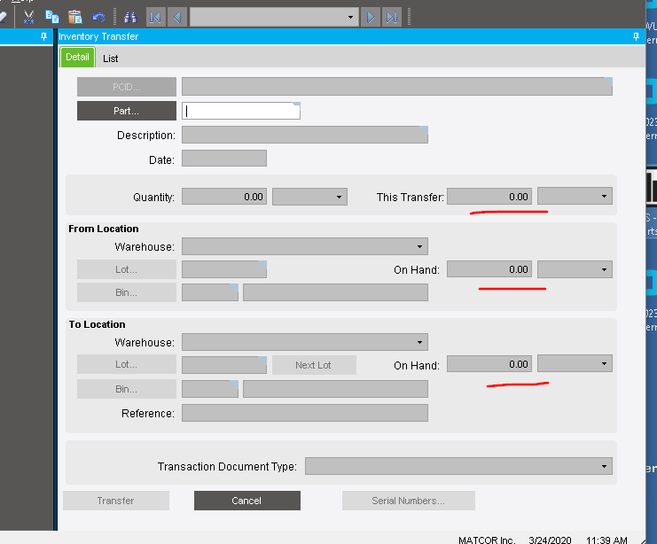

I just had this appear on another users machine. Different user, different parts, different box… everything was unique except for the symptoms. Attempting to do an Inventory Transfer of a item with a UOM of FT and could not enter a decimal value at all. Closed Epicor and re-opened it and it was back to normal.
