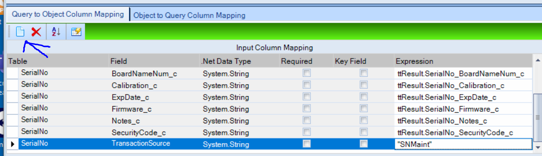

→ Table: SerialNo 5
→ Field: TransactionSource
→ Expression: “SNMaint”
4 File > Save

I’m a bit confused here. File > New will make a new BAQ.
What are we actually supposed to do?
So not that file New, but the New button in Query to Object mapping to add a field that does not exist in the Db to the transaction.
