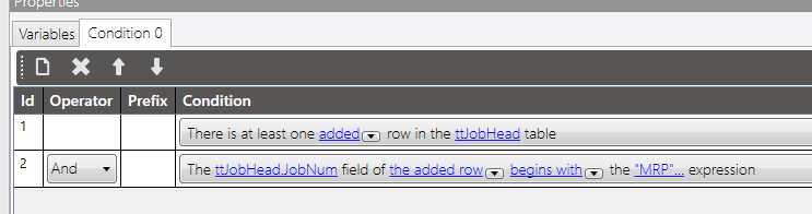

Hi Kevin, thanks for the suggestion.
Yes there is a condition ahead of the code:
Perfect. Just wanted to make sure. Welcome to the forum, btw!

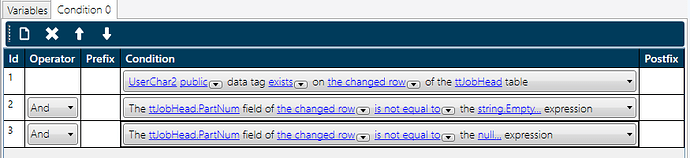

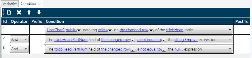

One thing you might consider: Perhaps that part number gets added during an update and not an add? Just thinking out loud. Something to try.
Oh yeah, if that’s the case then the standard directive I suggested won’t work as-is. However, if you were to change the first conditional widget (labeled “Has DataTag”) to include a second condition to check for a PartNum (below), then it would leave the data tag until the part num is added.
This was it, thank you! Not sure why I hadn’t thought of that.
I changed my conditions as follows:
This now updates JobHead.UserChar2 within the in-transaction Data Directive with the same code as posted in my original post.
