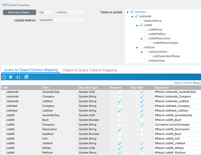

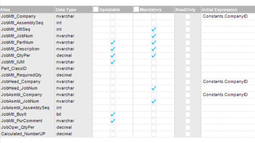

Please see the attached. I would prefer to keep it to this query, but if that is not possible, I would not be opposed to an event. Our current workaround is a Vlookup on the part description that way the user can copy and paste directly back into the dashboard.

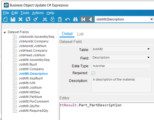

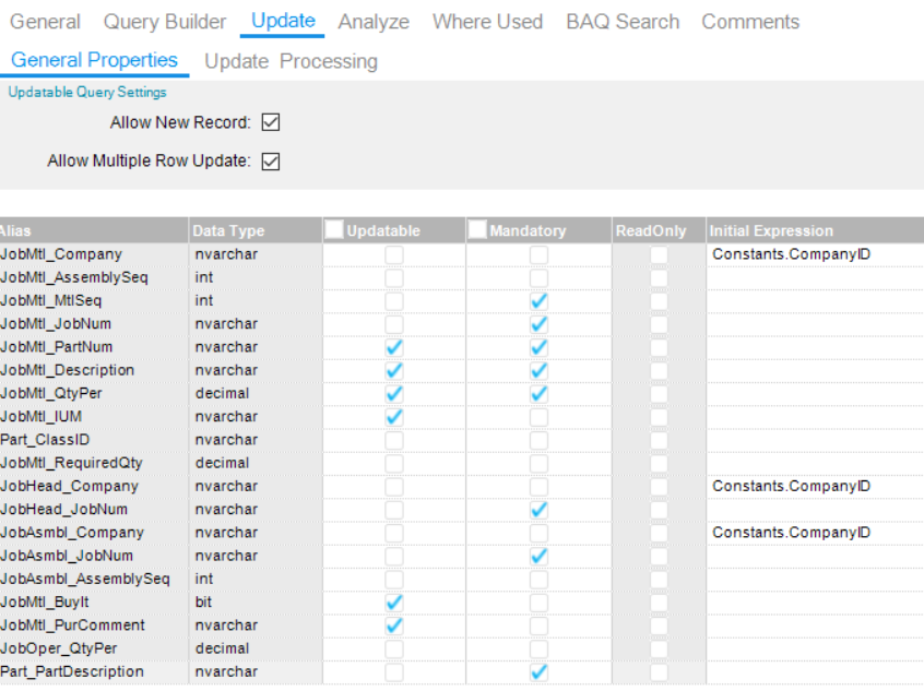

Add the Part table joined to JobMtl
Then the “Expression” for the material description will be (you will override it to) ttResult.Part_PartDescription

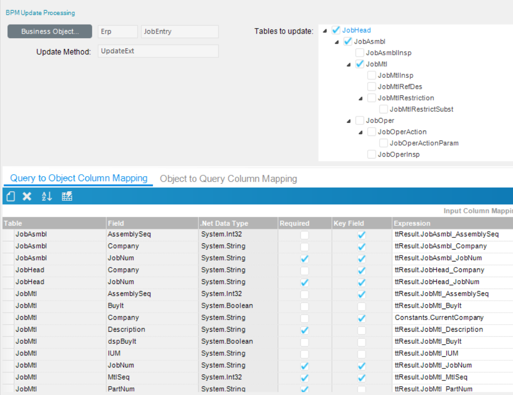

The UpdateExt methods bypass a lot of the logic that is in the application. I believe any “change” method is skipped, which would explain why the description is not updated as the change in the part number is not triggering the change part number method.
I tried this in Pilot and it did not work. I thought that would work like it did with the BuyIt check box.

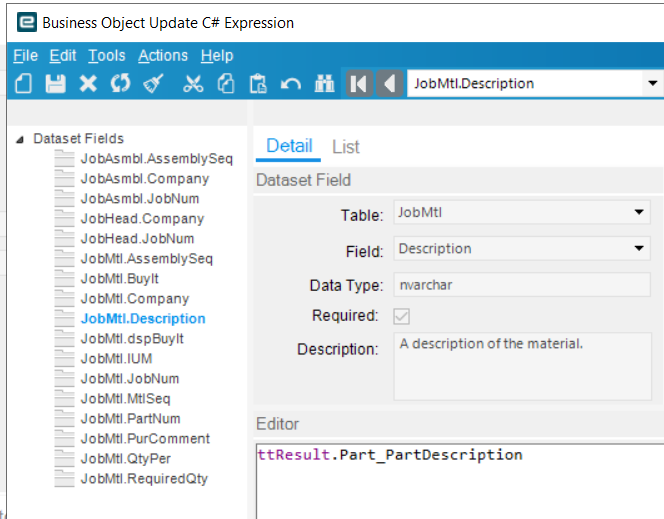

This is from Pilot
So it might not be possible to do this via the BAQ :pensive_face:
You can, but it would require “advanced baq” using code.
So can he not just use Update instead of UpdateExt? I guess I am just surprised (but not) at the limitation.
UBAQs use UpdateExt and you can’t change it unless you do an Advanced one like @Chris_Conn said.
