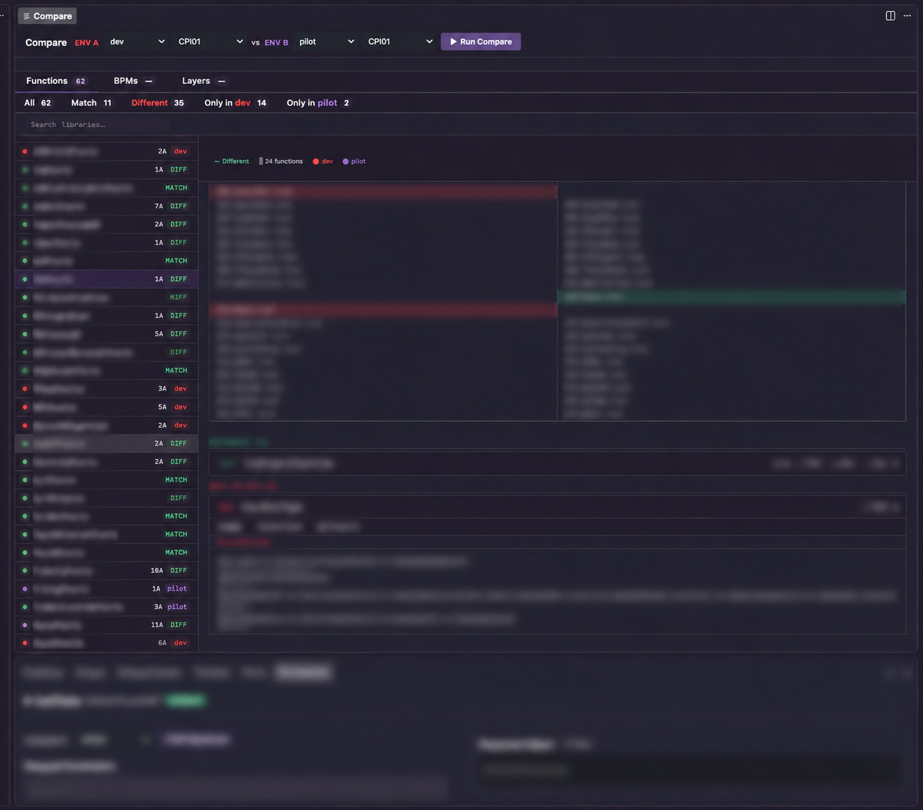

Environment Compare
Diff two environments against each other.
  • Functions tagged Match, Different, or Only in one side. Drill into any function for Code, Signature, and Metadata diffs, plus library level stuff like table/service/assembly refs and DirectDBAccess.
  • BPMs compares custom C# and widget structure. It parses the XAML, so real logic changes show up and dragging a widget two pixels doesn’t.
  • Layers Kinetic app layers per app, including ones that only exist on one side.
  • Any row opens in VS Code’s native side-by-side diff editor.
Pushing a function across environments
From the compare screen you can apply a function’s code from one environment to the other. It verifies the code actually landed before telling you it worked. If the target library is promoted, it demotes, updates, and re-promotes it for you.

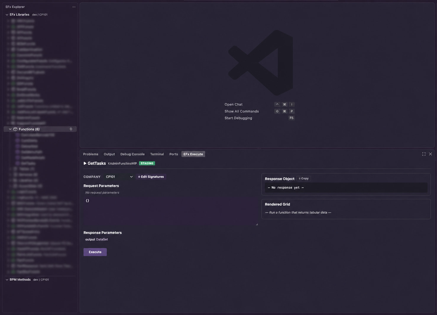

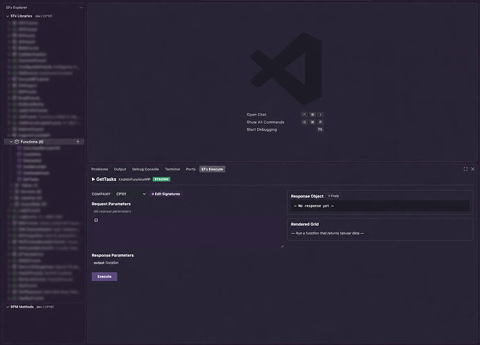

  • Edit function signatures (add/remove/change request + response params) and save them straight to Epicor
  • Visual editing for common BPM widgets
  • Multiple profiles and companies, with passwords/API keys in VS Code’s secret storage instead of a settings file
  • Promote/demote libraries, regenerate/validate, toggle table refs between read-only and updatable
  • Execute panel now lives in the bottom panel, and DataSet responses render as an actual table
