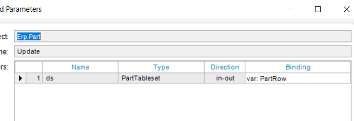

On the Update Getlist i have created a custom BPM which should update all the records linked to ttResult.
When i run the BAQ manually, i can see the fields (OnHold, OnholdDate, OnholdReason) are getting updated in ttResult, but what i am not seeing is the records in Part getting updated. But i am not getting any errors either.

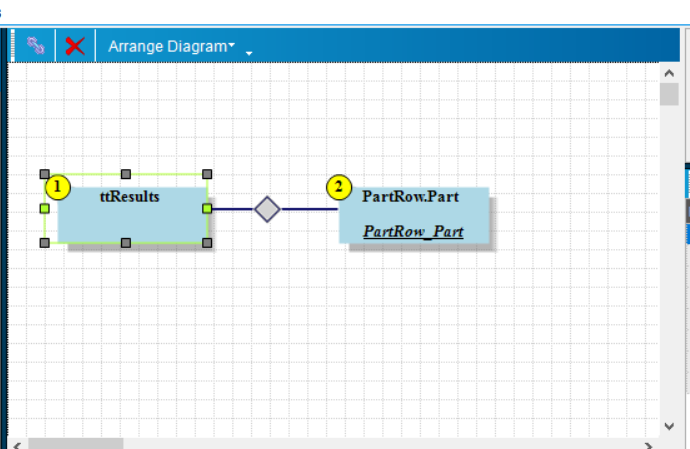

Here is the work flow i have created
My Original query which creates ttResults has Company and PartNum in, so everything is linked by Company and PartNum.
