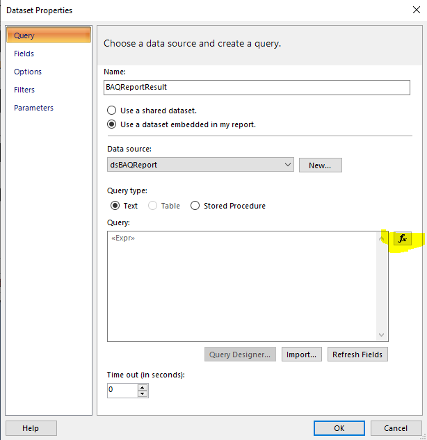

The usual method is to go into the report in designer and add the fields to the query:

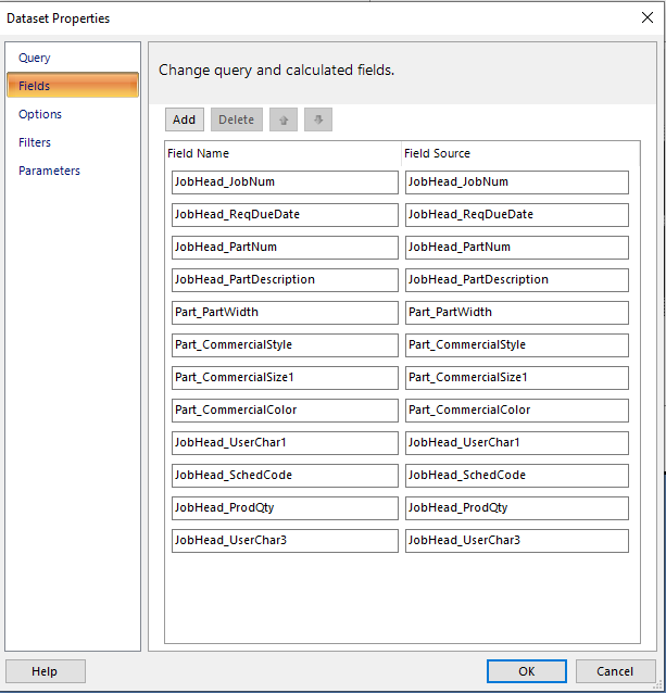

And to the Fields section:
Depending on the complexity of the report design and query I have either done this or started from scratch with a blank report created from the updated dataset, whichever is easier/sounds more fun to you at the time.
:point_up_2: This is the way. While it’s technically possible to make Epicor push your new field to an rdl, I’ve found it easier and more reliable to DIY.
