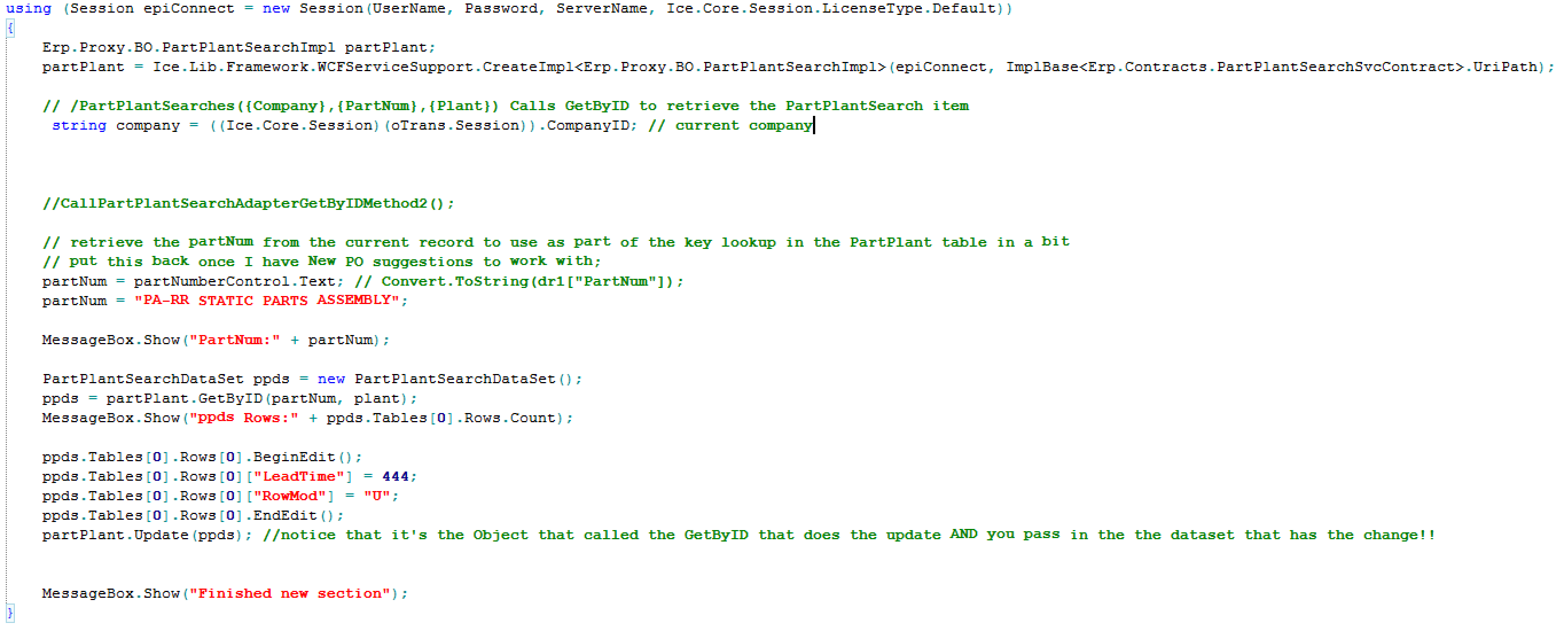

We are trying to update the PartPlant LeadTime field through the New Po Suggestions Form using the script editor. We were trying to access the lead time through
partPlant = Ice.Lib.Framework.WCFServiceSupport.CreateImpl<Erp.Proxy.BO.PartPlantSearchImpl>(epiConnect, ImplBase<Erp.Contracts.PartPlantSearchSvcContract>.UriPath);
We get an error that just says unable to update.

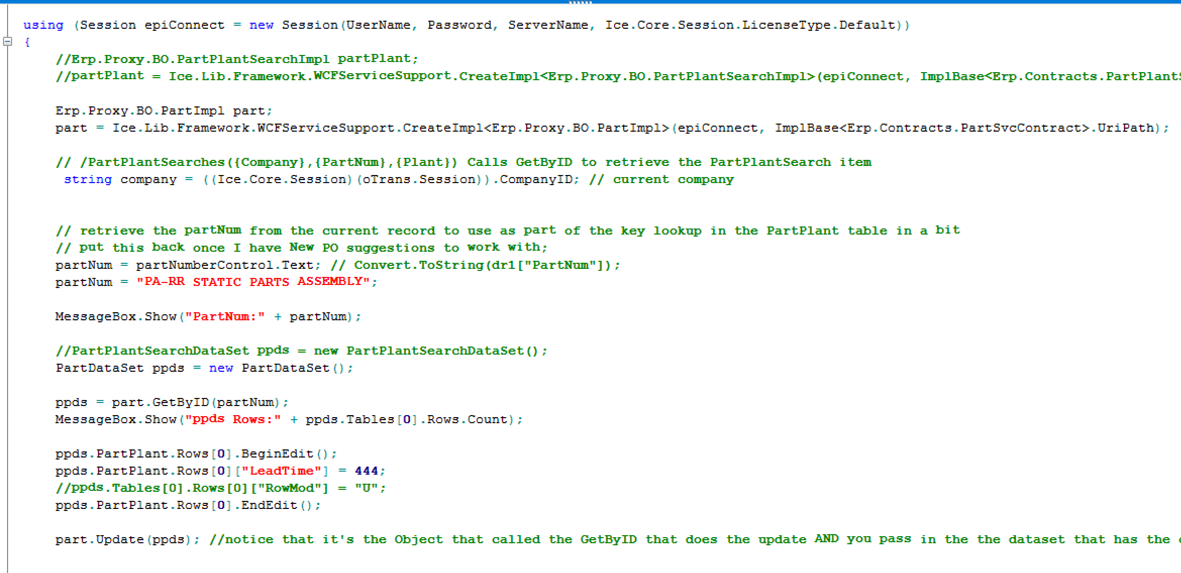

We figured it out. Thanks for the help! The previous error was because you need to go to the place you want in the dataset for the update (ie PartPlant). Will post a screenshot soon of the final working code for anyone who needs it once we get the user entries to work.
Yes. The Part Business Object contains a dataset of many tables (Part, PartPlant, etc). You would update PartPlant by getting the Part first.
The current working code.
Good job! FYI, if you use the Customization Wizard next time it would have written 90% of this code for you.
