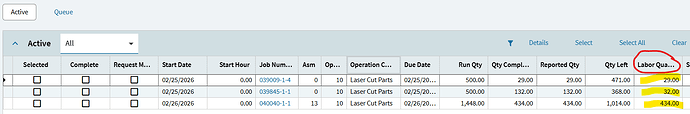

Goal: Update the LaborQty field to 0.00 on the MES Work Queue, Active Tab when the page loads

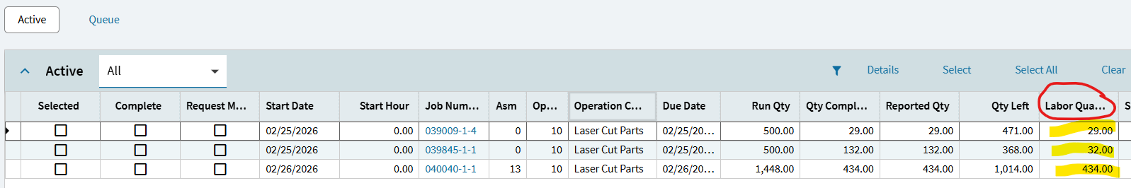

Why do I want to do this? If an operator starts working on a job with qty left to complete, the system will put the operator’s last run quantity into the LaborQty field. This confuses them and contributes to wrong labor qty.
I created an event after SelectAllForWork to row update the ActiveWork.LaborQty value to 0.00. This event is working for the first row only.
I then followed the instructions to Iterate Dataview rows to update values. Kinectic Application Studio - Iterate Dataview rows to update values - #2 by klincecum
It is iterating but only updating the first row. After the first iteration, event ColumnChanged_LaborQty triggers. It does not get re-triggered after the 2nd and 3rd iteration to update the LaborQty to 0.00.
There is a second problem to my plan and it is if an operator starts labor active and has jobs on the Active tab, then logs out (not clocks out) of MES, when they log back in to the Active Work Queue tab, the Labor Qty reverts back to old numbers because SelectAllForWork never fires.

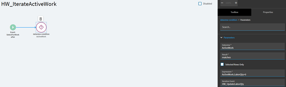

This usually points to a wrong setting in your iterative event.
Your dataview-condition should look something like this:

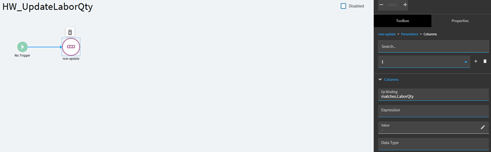

In your iterative event… I’m assuming you’re doing a row-update?
Make sure that row-update is updating the Ep Binding of matches.LaborQty (or whatever the column is your trying to update). NOT ActiveWork.LaborQty.

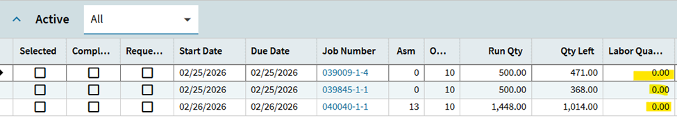

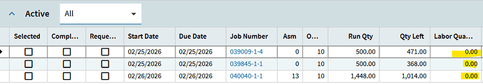

Many iterations…and with your help, I finally have it.
Result:
