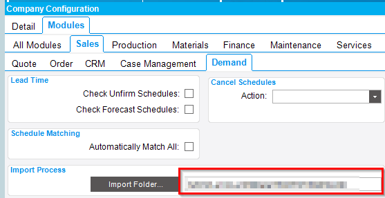

I’m working on a script that automates our environment post-refresh tasks via a BPM like updating company name, report style EDI locations etc. I’ve got most of them working except this darn Demand Import Location on Company Configuration:
I’ve traced and I’d need to update XbSyst.InboundPath however this field does not exist in the DB or the returned data set from Company.GetByID(). Any ideas how I could update it programmatically?
Hmmm, I think I found it. It was not available in BL Tester but is available in the BPM Update method :slight_smile:
this.companyAdapter.CompanyData.XbSyst
XbSyst.InboundPath = value;
