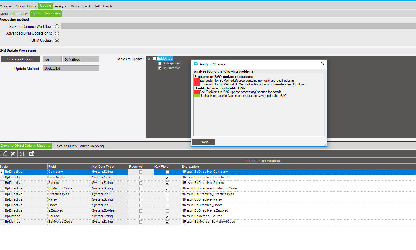

I am trying to create an updateable dashboard so that I can easily enable/disable Data Directives.
Has anyone been able to accomplish this.
I am running into this error.
make sure you have all of the fields selected for display that are listed in the mapping.
That was it. I needed to add the BPMethod table. Thanks!
Whenever I do a UBAQ I pretty much get what I need, then hit save and take a screen shot of that message so I know what epicor needs and that I need to add.
