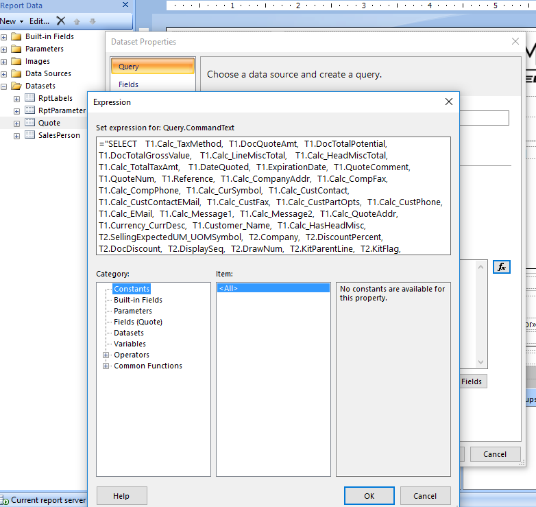

Is the “1 more field” you need to add in the POForm RDD (Report Data Definition)? If not then it needs to be added. Once in the RDD, it needs to be added to the Dataset in the SSRS report. (Hint easier to copy/paste the query into Notepad++ than try to edit it in Expression.
