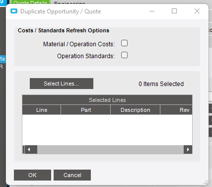

Also, when duplicating a quote, the rates from the source quote are copied over, not the current rates from the resource groups. Any way to avoid this other than a BPM?
