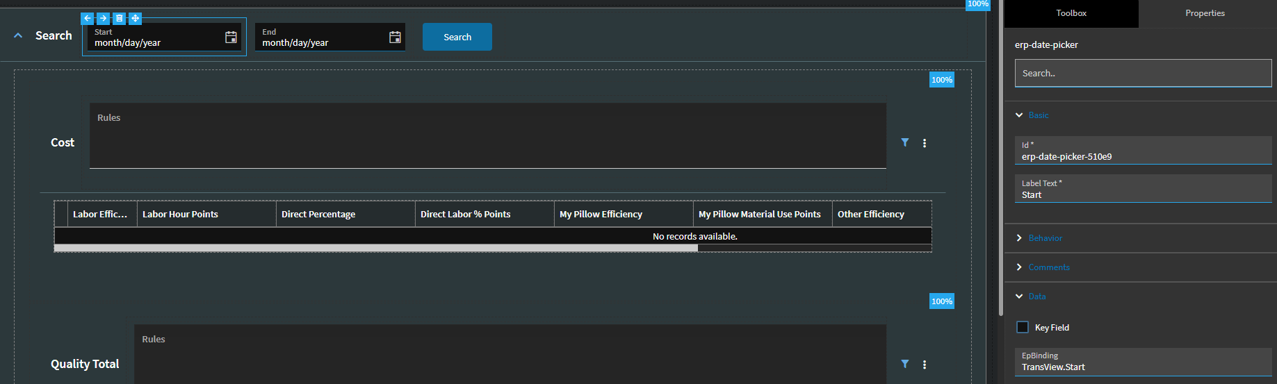

I have a BAQ that I used the application studio wizard to make a grid. This BAQ has a parameter or sometimes multiple. I want to be able to have a Text Box with the parameter in it when a user initially sets it for the screen, then have a button when changing that text box on the BAQ Grid screen that pushes any updates to the parameter and updates the Grid.

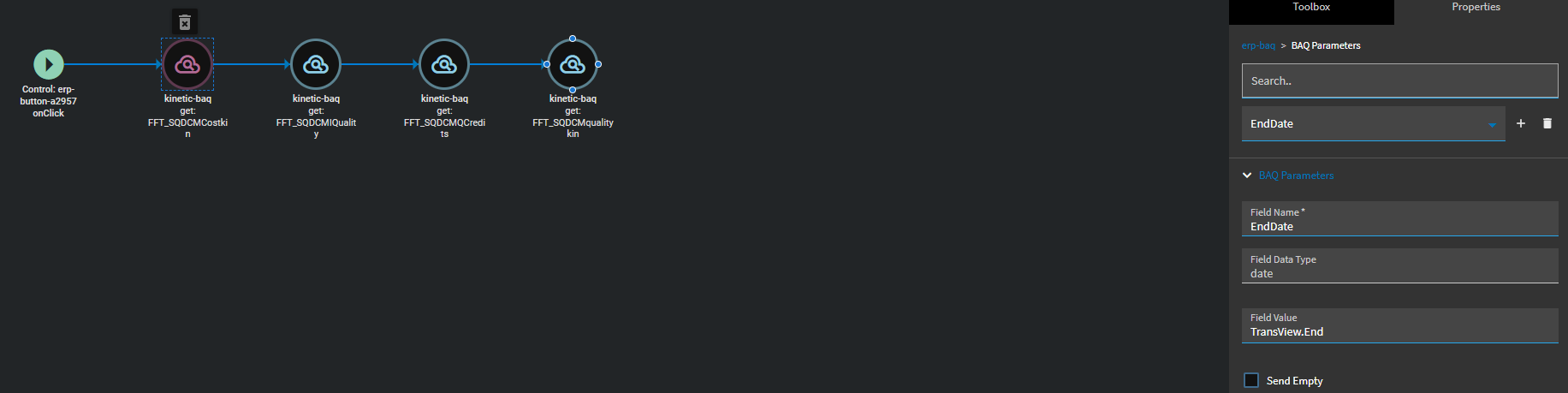

Hello, this should also be useful. And applies to any parameters your BAQ has- just make sure each control you create has the data type you need for the parameter.
