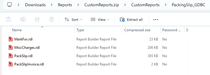

I tried these three combinations before I gave up and went back to calssic.
top is correct:
RDLs in here just like the OG file downloaded:

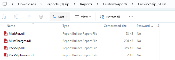

\reports\CustomReports\SOMEREPORTNAMEHERE
also file MUST be named reports.zip not reports(9).zip
That was it! Gah… I hate Kinetic.
