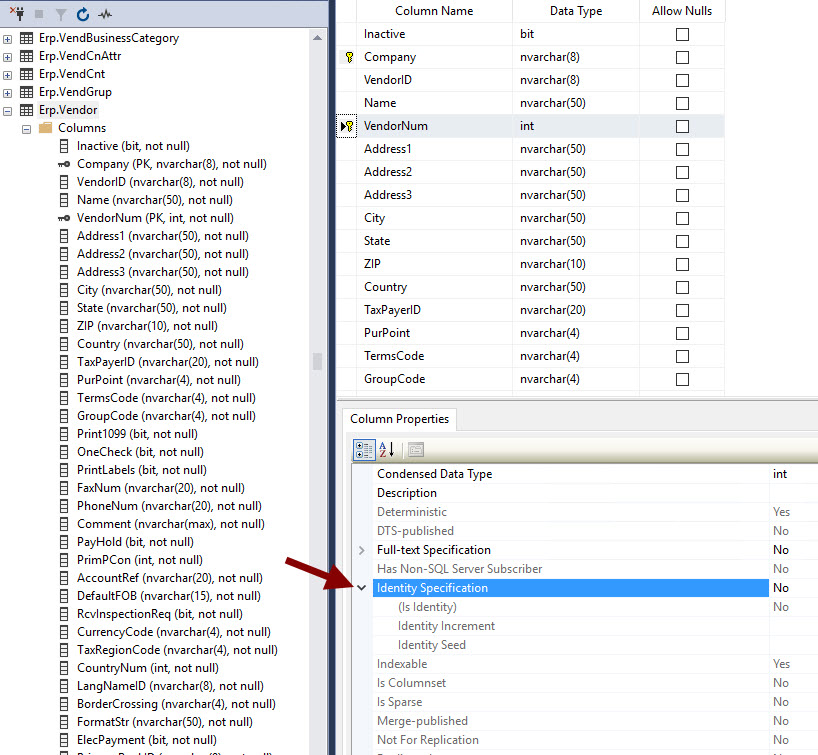

We’ve tested it and it doesn’t set the vendor number we provide, it assigns it a new one. It starts at 1 and increments for each record. And inside the database table, it looks like the Vendor.VendorNum is not an IDENTITY column.

I would try to set the entire range and DMT them in sequence. Then run a second DMT to remove the unwanted vendor numbers.
There’s VendorID and VendorNum. Like the previous poster had mention, VendID can be changed. You will probably need to change the report to use VendorID. When we originally started Epicor, we were aware of company field however we never added the company links to our SQL JOINS. Few years later, we are multi-company and we had to change all our SQL stored procedures/queries with the company joins. it was painful but it was the correct method.
You can match your old VendorID to the new VendorNum too.
Do what Greg says. Create a simple DMT template containing the VendorID and Name only. Sort the data in this DMT template to be in VendorNum sequence. Any gaps that you have because records were previously deleted would need to be accounted for in terms of a dummy/placeholder record. Then, again like Greg says once you’ve got the vendors created with the VendorNum that you want you can run another DMT in Delete mode to remove the dummy vendors you just created.
2nd stage would be to DMT in the proper data, but this time use VendorID and not VendorNum.
