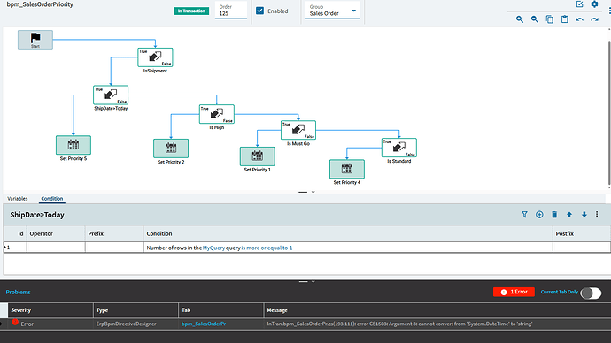

The upgrade to ERP 2026.100.x has brok BPMs.

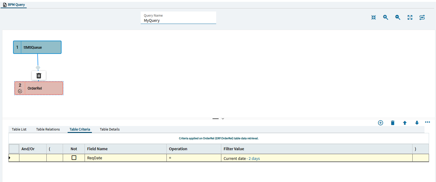

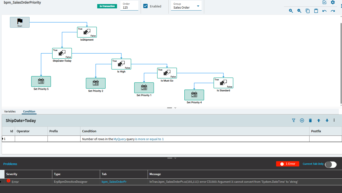

We usually just need to enable the compatible checkbox, which resolves the issues with any BPMs, however I have one BPM that won’t save due to the following error:
InTran.bpm_SalesOrderPr.cs(193,111): error CS1503: Argument 3: cannot convert from ‘System.DateTime’ to ‘string’

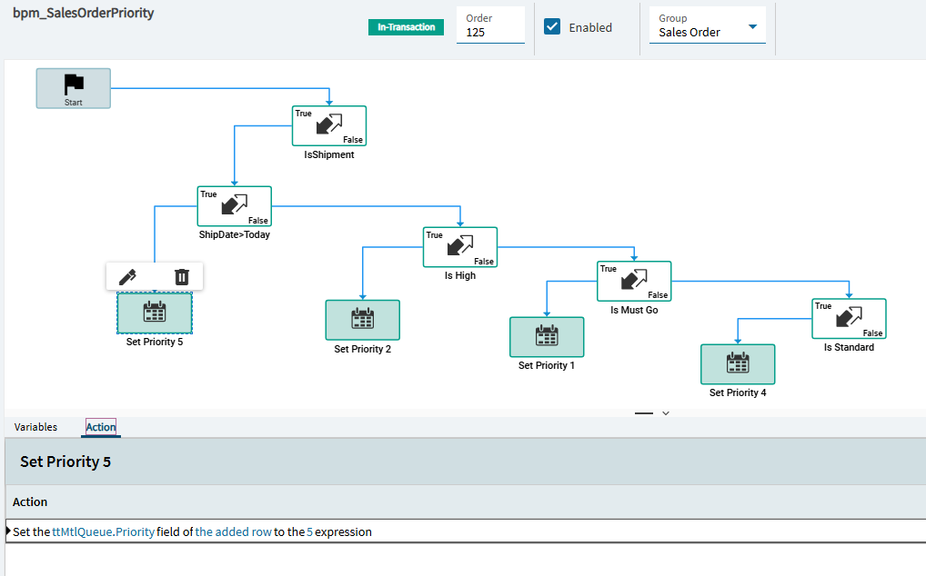

As per the image below; I’m pretty sure the issue is related to the ShipDate>Today condition and Set Priority 5 set field widget.
Can anyone shed some light on why its trying to convert a DateTime to a string?
The Set Priority 5 widget MtlQueue.Priority field is an int32, and the 5 expression is also an int32.
If you need any more info, please just ask.

There’s somewhere in your BPM where you are setting a string to a DateTime. I’m not seeing it based on the screenshots you posted so far.
that’s what I thought I noticed too…

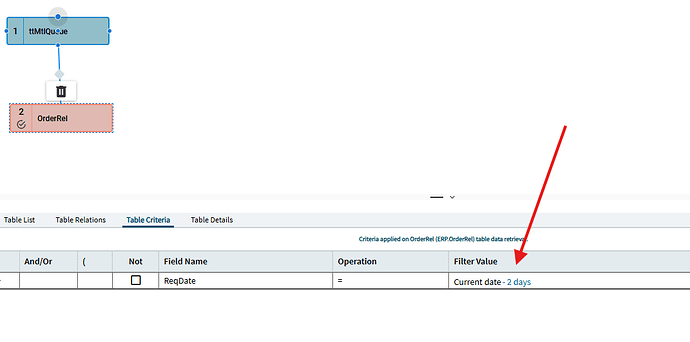

I found the problem.

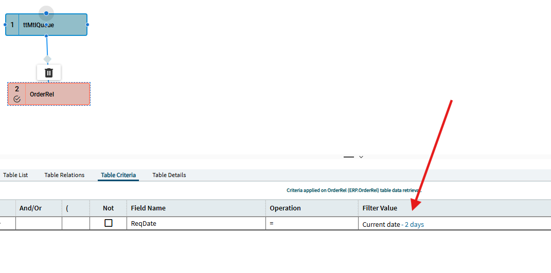

Its the ShipDate>Today condition thats the issue.
If i change Filter Value to BAQ Today Constant (As a test) it works fine.
It doesn’t like the Current date filter.
How can I achieve -2 days without using Current Date filter?

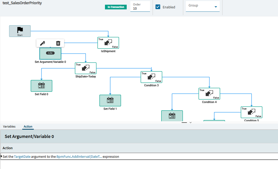

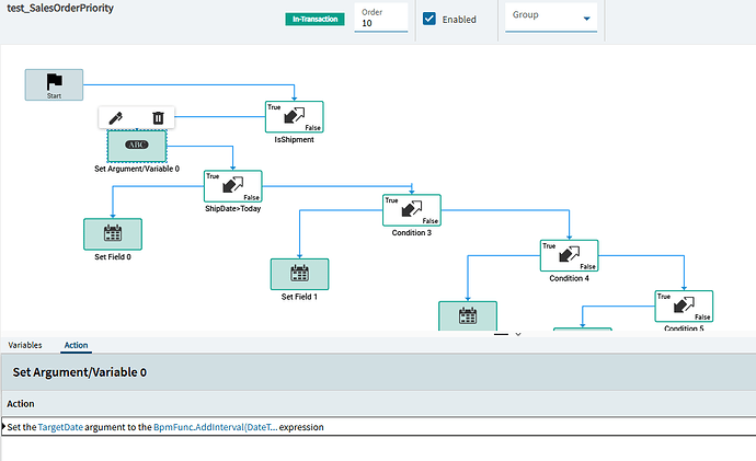

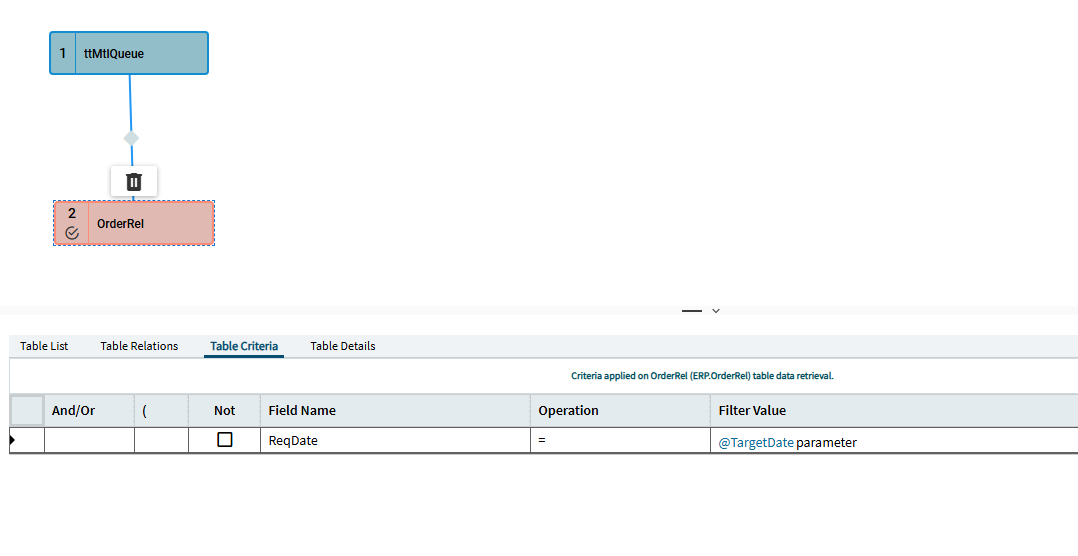

Managed to fix this using a variable and set argument widget.
I added a variable called TargetDate as a DateTime.
Then added a Set Argument/Variable before the condition, and set the variable to TargetDate and the expression as 'BpmFunc.AddInterval(DateTime.Now, -2, IntervalUnit.Days).
Then in my condition query i set the filter to my variable TargetDate parameter.
