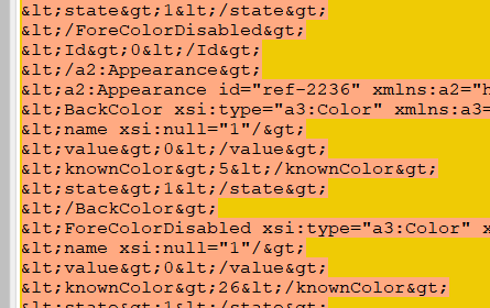

Thats a lot of addition of junk, bloating the XML (the Customization Download speed etc)…
400 vs 600
Do we really have to store the colors, appearance etc… some x coords…
