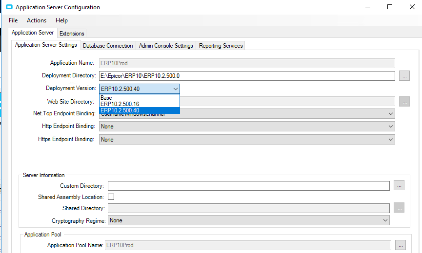

I am currently looking at upgrading from 10.2.500.40 to 11.2.100.26.
Here are my concerns. I have upgraded from 10.2.500.16 to 10.2.500.40 but cannot remember how to do one part. I have attached the screenshot that shows the dropdown where prompts you to choose the deployment version. How do I get that deployment version to show the 11.2.XX versions? Is it safe to install that 11.2.XX version on the same SQL server as our Prod instance for 10.2.500? I tested this on my Windows VM and it made me install the base 11.2.100.0 version first, then I ran the .exe for .26 and I was able to get the admin console to open. I just want to try and install this myself and test for proof of concept. Is there anything else that I am missing?
I have a feeling that I need to put this all on a separate SQL server because I need to backup Prod and restore that to the new version and run the upgrade and conversion workbench.
