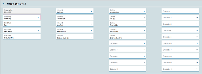

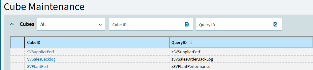

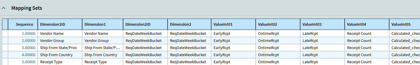

You could use standard functionality which is to build a cube in Epicor.
The executive dashboard allows you to run a baq on a schedule and populate the results into a cube that has “UD Like Fields”
there are a four key fields, 10 - decimal, 5 - intergers and 10 shortChars
I have done this to determine how many PO Suggestions buyers were getting every day so we could determine their workload.

I’ve not work with executive BAQs and Cubes before. You say these UD like fields, so they are not really UD fields? I wonder if I could do something like this then use a BPM to set the data to the UD fields I have so its saved for posterity.
I need to research Cube maintenance.

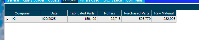

So I’ve rebuilt my BAQ and now have everything in one query with a single row returning the sums of the 4 groups I need.
Now I want to get that data into my UD table where Key1 is the date and Numbers 01, 02, 03, 04 are the group totals. My goal is to have the query run each night after business hours and populate the UD table. What would be a good way to do this?
