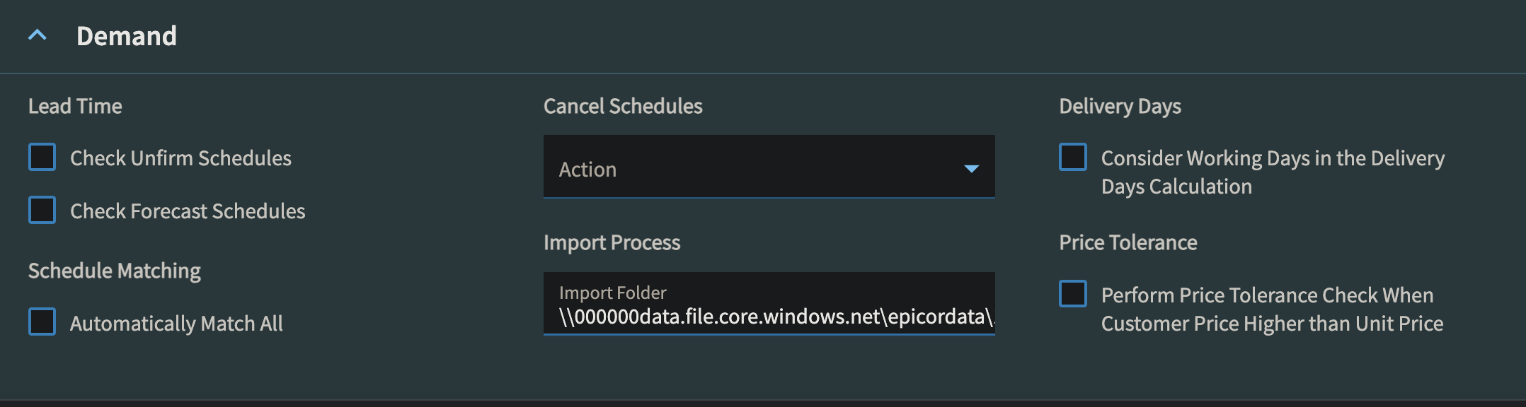

You should have access to an Azure File Share in SaaS. It looks something like this \\00000data.file.core.windows.net\EpicorData
If not, open a EpicCare ticket to have them provide one to you.
In the file share, you can upload your .app files to your desired directory, and in Company Configuration → Modules → Sales → Demand, put the path to your Azure File Share in the Import Folder box.
Example being \\000000data.file.core.windows.net\epicordata\000000\EDI
You should then be able to run the Import EDI Process, and it should pickup your .app files and process them.
Hope this helps!
