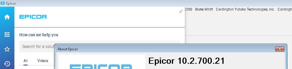

Hello I updated Epicor from 10.2.700.11 to 10.2.700.21 and installed the update and all is well on the remote application server

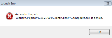

but when a user tries to open Epicor from the remote app they are greeted with this error

I assume the icon is in the public folder, so it shows up for all who connect?
If so, you need admin rights to update that. Try running Epicor as administrator to see if it allows the update to run.
it was desperate because it was causing more unexpected downtime. We use the remoteapp manager (Local RDP/RemoteApp Manager - Devolutions) for our associates to connect and it kept throwing that error. It was due to the config some how. I took the main Epicor installation files and moved them to a separate folder and pointed the remote app location to it and it seems to be working fine now. Thank you for the fast help. I appreciate it!
