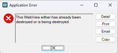

When using the dashboard we find the first two have no issues but the “GOLD Documents” throws an error after clicking the “download” control.
We initially tried the browser within a customization but found that it created a memory leak. I’ve also noticed that the “download” control actually functions as intended displaying the ability to ‘Open’ or ‘Save’ the item. Preferred is the customization route but open to using the dashboard if we can get past the errors.

Dashboard Error2
Dashboard Error1
