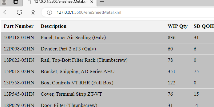

I’m trying to create an XSLT dashboard. and I feel like I’m so close to getting it to work. I’ve got the XSLT file working against the sample data file giving me html output of what I want to see.

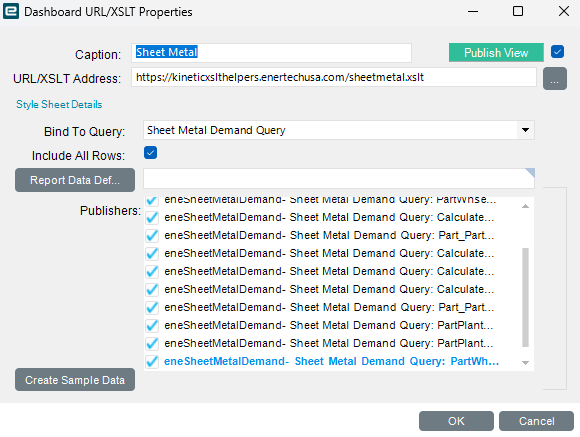

I created the BAQ query in the dashboard and I’ve created the URL/XSLT control

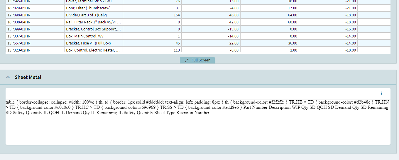

But when I got to preview the Dashboard, I get the following
Which is the XSLT file with the HTML stripped out and no record data. Is there any good tutorials or direction on how to get this to work?

I have noticed that when I use the sample data locally with my XSLT file I have to remove the standalone=“yes” attribute of the XML file for it to render in the browser. I feel like this might have something to do with it.
If I use just a URL, it renders the website in the control correctly. But the XSLT option still only renders the plaintext version of the XSLT file (without any of the data, just the contents of the XSLT)
