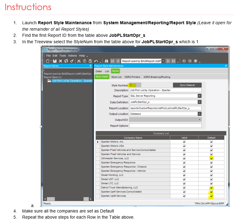

You are correct. I always had to provide additional post-deployment instructions such as:
But since we are on-prem I shifted to providing a SQL Update Statement which sets the defaults, I havent tried DMT or a UBAQ Dashboard.
