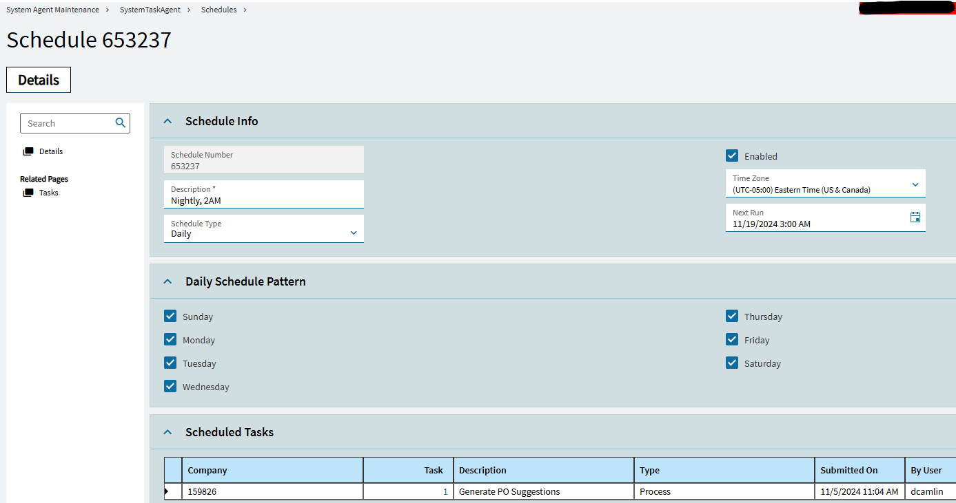

At the risk of sounding dumb, is there a way to see if they are on a schedule? I can view the tasks and the task parameters but it does not show me who is getting the reports.
Well, the more I think about it, I doubt this is your issue… but since you asked…

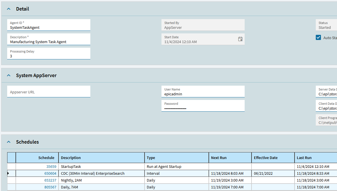

I’m SaaS and it looks like you’re on prem, so, not sure if it may be different for you. But I see our reoccurring tasks in the “System Agent” menu.

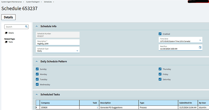

You would see a list of schedules like above. Some set to run daily, others could be set up at an “Interval”.
When you look at a particular schedule, you can see who added/assigned a given task to that particular schedule. For example, I set up our “Generate PO Suggestions” to run nightly at 2AM every night… so I see my user there.
The fact that your issue is occurring every couple minutes makes this seem pretty unlikely, unless someone set up a schedule to happen very frequently. And even in this case… I don’t have to be logged in for this process to run, so, this doesn’t seem related to your issue.
