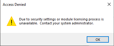

I was able to re-create the situation using the TestUser account. TestUser can access the folder, but gets a security error when trying to access the BAQ (UD) menu item.

Can you post the full “details” of the error? Maybe there’s a breadcrumb in there.
Sure.
