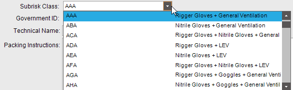

I have a field which I want to drop down - for user codes, showing User code ID and Description inside the drop down box - at the moment only one column appears in the drop down which is the description
How can I modify to show the two columns form the user codes table please?

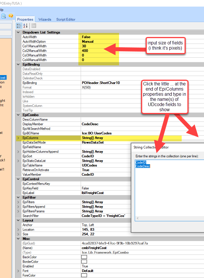

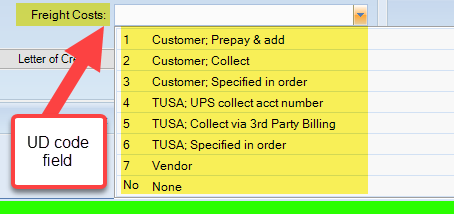

To get something similar to below with multiple columns showing in your UDcodes field:

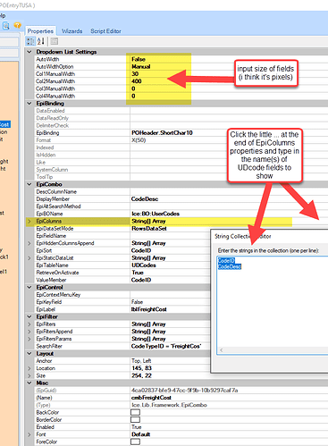

And then go to the EpiColumns … and tell it what fields to show; edit the column widths to show the data. PS: i have found the column sizing here a little buggy, sometimes requiring messing around with it to get it to work as needed
All sorted now thanks so much for your help - my problem was because I had the code in the wrong place. once I put it in initialise custom code it worked a treat
