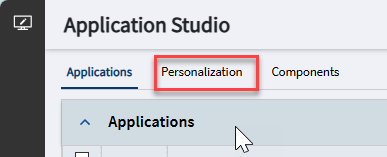

In Application Studio, the Personalisation tab doesn’t have this Dashboard.
Is there another place / way to check personalisations - and or Purge them - there used to be right?

This has helped me in the past: Need votes for a program to remove kinetic personalizations - Kinetic ERP - Epicor User Help Forum
Also, be fore you login to Kinetic there is a link on the login page to “Reset application back to defaults”. That has also fixed a lot of issues like this in the past.
Good luck!
You probably need to delete the browser cache. Delete the browser cache (settings … ) then restart Kinetic.
Since 25.2 there has been a built in personalization manager in App Studio. This is where I now delete user’s personalizations. Sometimes have to also clear the browser cache too.
