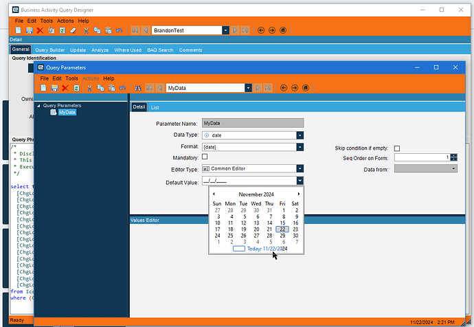

Using a formula for BAQ parameter default value?
Is there any way to apply a formula to a BAQ parameter’s Default Value?

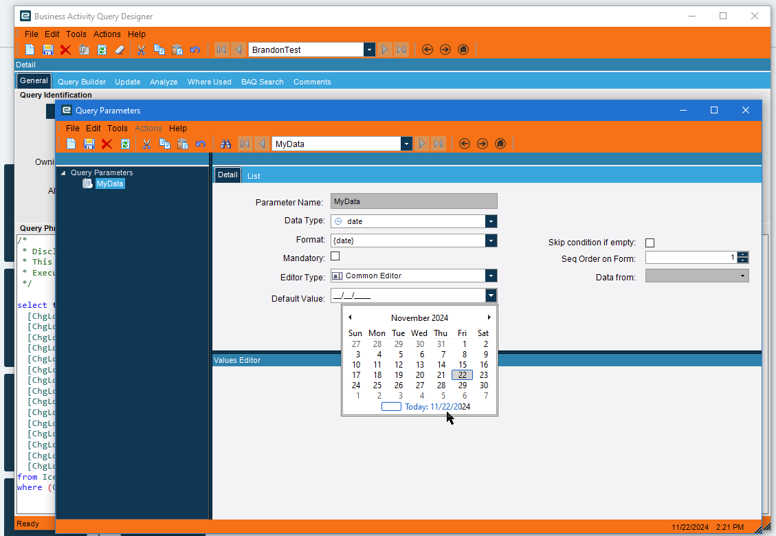

Specifically, I have a BAQ with a date parameter which I would like to default to [Today+90 days]. But all I can do is default it to Today (edit: this is in RDD Criteria prompts, not in BAQ parameter options).
I see no ability to do this kind of a formula, yet it seems like such a simple thing, I’m hoping I’m overlooking something.
(I suppose worst-case I can change the parameter to a dropdown type, and then have a second BAQ which calculates [Today+90] date and outputs that single value. Then use that second BAQ to supply the dropdown value for the parameter in the main BAQ.)

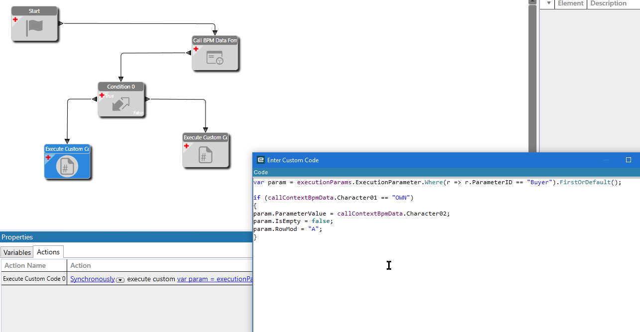

Let me play around with an updateable BAQ. I think you might be able to put a BPM on it.

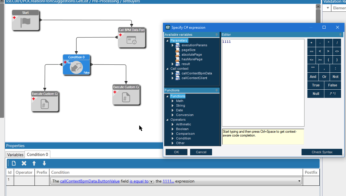

You need to use a BPM data form. If you call that on pre-processing get list then can use those values as your parameter. Once you have a BPM data form, you can make and apply a UI customization to do what you want to do. It’s ugly, and BPM data forms are buggy when moving around, but once they are in place, they work ok.
Ugh, yeah that seems ugly. Ok, it at least confirms that I hadn’t missed something simple, and that there is a workaround if I get desperate.

Right, no, it’s a whole process to make a control (combo box, date picker, etc.) for the parameter and then create a data view and then initialize a row in the view and then bind the control to the view then call the BAQ with an event and pass the parameter from the view. And don’t reference the BAQ in the grid because then you get the parameter box popping up relentlessly with that static default value.
The default value field for a date parameter brings up a calendar date picker. There is a ‘Dynamic’ checkbox option in the RDD Criteria prompt (not the BAQ), so I’m assuming that selecting ‘Today’ in the date picker and selecting ‘Dynamic’ will always choose today’s date.
[Edited for correction of Dynamic location.]
This BAQ is for a report (RDD+RDL).
The Criteria Set in the RDD has similar limitations to the BAQ’s parameter setup.
We’re still primarily on Classic UI, so I’m not planning on making any customizations to the report screen.
For what its worth, I ended up using the Dynamic date option on the RDD criteria prompt.
I chose the “End of Month + 3 Months” as the default to approximate a 90-day date range.
[Edited to remove reference to ‘Dynamic’ in the BAQ itself.]
But not in the actual BAQ. You keep saying that, but from what I know, there isn’t any way to set a dynamic parameter in the BAQ. Are you talking about the report parameters?
Doh! Yes, you are correct: no Dynamic option on the BAQ itself. I’ve been trying so many things, and jumping around, I got myself confused. Sorry.
