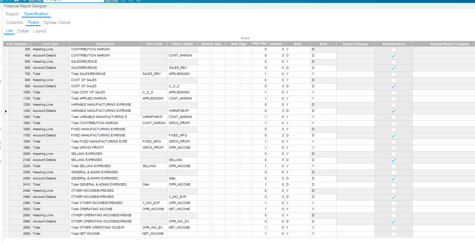

I don’t know if it helps, but ours looks like this. My old boss created it and I have modified it. But I have never made one from scratch. I remember the totaling can be tricky (and counterintuitive).
We don’t specify accounts - I don’t think. (It’s the “Select Accounts” box, right?)
Yeah, I can select accounts and when I do the totals work. It’s when I try to do it by category that it returns a blank stare.

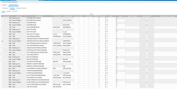

Having no real experience with Balance Sheet report writing in ERP systems, I didn’t know to change the following:
Once I did this, everything worked as expected. I let support know and they are going to make a knowledge base article about it. I’m not sure how this will effect wanting to do reports for all of the companies, but we still have to get the consolidation process done before we worry about that.
